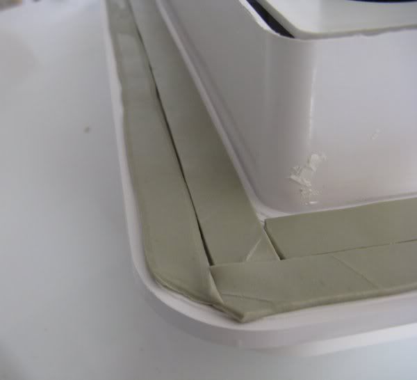

I've done 4 trailers with either a roof vent or sun roof. I use butyl tape, the same for my windows and have not had any leakage. Plumbers tape may also work but I've never tried it. :thinking:
P.S. I installed a Fantastic Fan Vent on my Field and Stream that I'm restoring and sealed it with Butyl tape. It sat under some heavy rain last week with no leaks.

I did the same as Gage, and added a bead of silicone for good measure. Not a drop.
The butyl tape stays flexible for years, it's what they use to install windshields. It will not leak when installed properly. I actually laid my butyl over the screw holes on my vent. I used about 1/2 wide bead, by 3/16 inch thick. It compresses very easily when your screwing down the vent.

Put me in the camp of using butyl tape AND sealant. I did not use the enclosed foam gasket. Like MJ said, go get some SS screws and use them instead of the included screws. Also seal each screw hole with a little sealant before you drive it in.
Not a single leak so far and it has rained almost every time we have camped. (knock on wood) :thumbsup:

Any RV shop will have Butyl tape. Here you can buy it at pretty much any decent hardware/building supply store on a big roll. They use it to seal between the ridges on R panel metal siding where they overlap.

I got some at an RV supply store, but you should be able to get it online. It is really good stuff. It kind of feels like dense putty, and stays soft. Very easy to use.
I would still do a bead of good caulk around the edge for redundancy.
