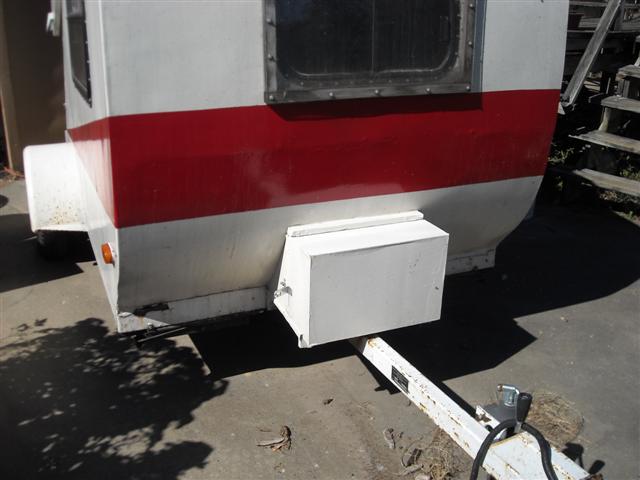

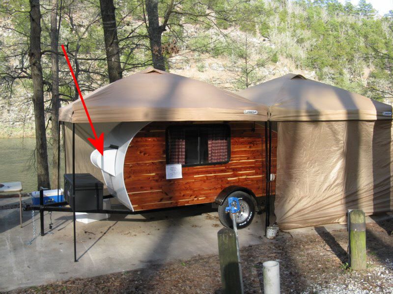

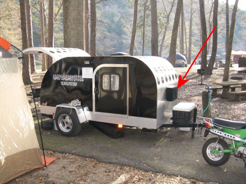

Postby planovet » Thu Oct 14, 2010 6:11 pm
It's been done several times. You have to make sure and build an enclosure for the AC or water will get in if you are driving in the rain.
A couple of examples I found real quick:

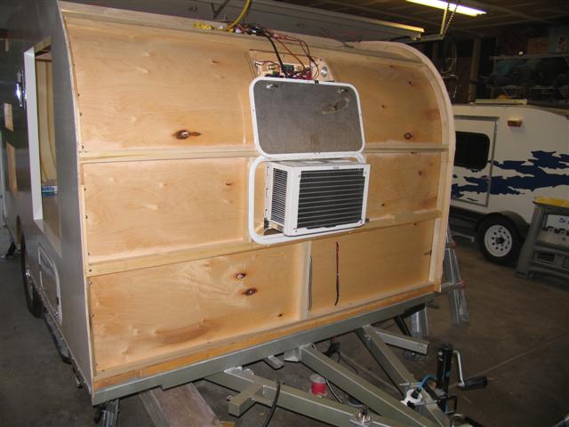

Postby mikeschn » Thu Oct 14, 2010 6:53 pm
Gary has one on the Winter Warrior that worked well.
The one I stuck in the wall of my Winter Warrior leaked like a sieve when I first installed it. It took a lot of weather stripping to keep it from leaking. But still, I think Gary's design is better. Gary, got a pic of your design handy?

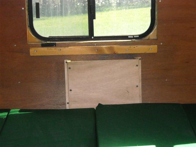

Here's mine...

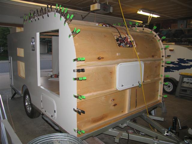

Postby bdosborn » Thu Oct 14, 2010 9:40 pm
Now you see it:
Now you don't:

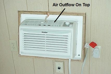

Building a TTT with galley in front, and planning another, ditto, I put the AC in the rear where water wasn't blown into it when driving so it didn't need a cover.
It was positioned where it might blow on the heads of anyone sitting on the couch, so I bought a Haier 5K BTU unit that has the air outlets that blow UP and OUT. You might consider that factor in a TD. Having one blow air up toward the ceiling rather than directly over you while sleeping in it might be preferable.
