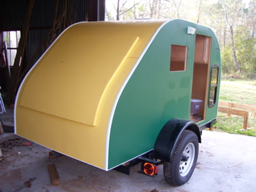

From the EVAC A SHACK:
ImageMark (& Cindi)

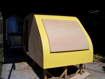

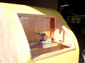

Postby S. Heisley » Sat Dec 25, 2010 6:30 pm
PArnold built his that way:
