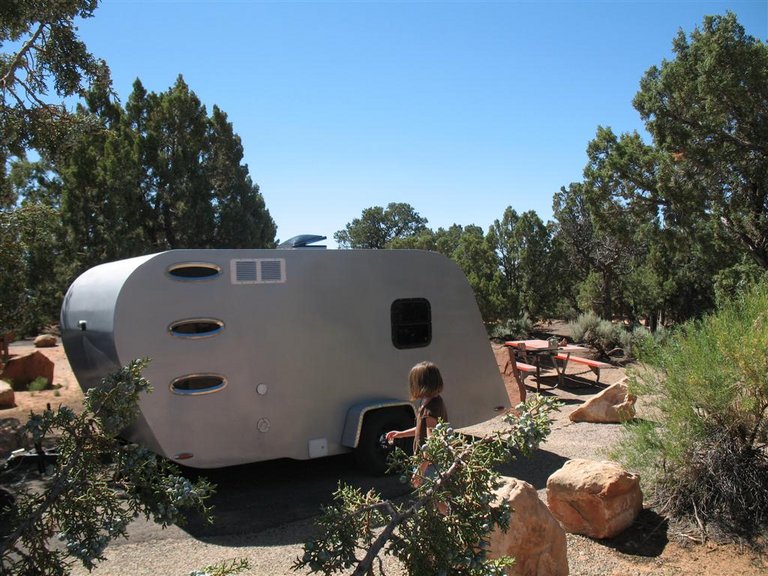

Or, you could ask Mike how he did his round windows.
http://www.mikenchell.com/Generic_ET_Photo_Album/slides/IMG_3268.html
