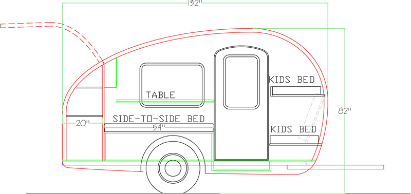

Postby Archeo Robert » Mon Jan 10, 2011 11:04 pm
By sleeping side-to-side I could use the extra space to shorten the trailer to 11' long and put in a small galley. I would like to make the trailer as small as possible and still be comfortable. I guess I am just humoring myself at this point. I think that the Campster has a really nice profile to begin with and it would be hard to improve on that.
Real rough modified layout.

Postby Miriam C. » Tue Jan 11, 2011 12:11 am
:thumbsup: Mike is over 6' and we sleep side to side. The outside is 76 inches. Only 10' long and I made the galley accessible to the inside. I bought an electric hotplate for heating stuff inside. I would be cautious about boiling water close to kids and inside.
I don't use the whole galley area just for cooking or food prep. Part of that area is for the air conditioner and battery. That might change though.

Postby mezmo » Tue Jan 11, 2011 1:47 am
Hey Archeo Robert
Here's a vote for your 01/11/11 iteration of the design.
It seems an ideal solution for smaller size and comfort. It
has what you want/need. The rear kitchen with hatch is a
most practical solution for small TT. Your design is a nice
amalgam of TD & TTT, sort of combining the best of both
ideas. The angled seat back that swings up to be the top
kiddie bunk is a solution for two needs. Seating comfort and
kiddie comfort!
The profile is just as attractive as the original I think.
Best of luck as you go forward.

Postby Archeo Robert » Tue Jan 11, 2011 11:23 pm
Thanks, Miriam
It's always good to hear some advice and get some perspective from real live observations. I think that it is easier to design a home or kitchen than figure out everything that you want in a Teardrop and then realize that somethings need to be omitted or added. But it is fun I guess that is why we all do it.
Robert
