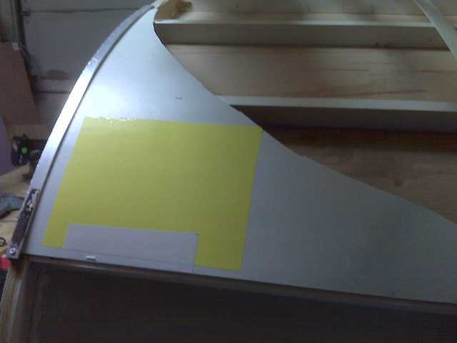

Here is another picture showing several tests going on at once. I am considering using the FRP for the roof as well. Not sure yet. Also tested annealing an old piece of aluminum angle I had laying arond. Turned out to be easier than I expected and worked pretty well.
I had some yellow vinyl so I stuck a piece on here just to see how it behaved on a curved surface. Simple curves are easy. I apply it like window film, a squirt bottle and a squeegee.
You could probably go by a local sign shop and ask for some scrap pieces to experiment with.
