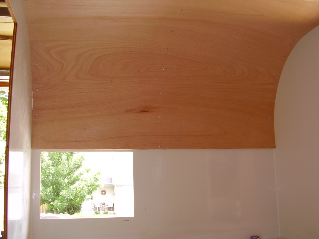

Postby Gerdo » Sat Jul 16, 2005 9:57 am
I have 5.4mm (3/16) birch plywood for my interior and I need to bend it around the front curve (20"radius). Are there any tricks that will help it more flexible? would getting it wet help?

Postby Gerdo » Sun Jul 17, 2005 6:00 pm
Well I cut and then hosed the ply down with water. I kept hosing it down for about an hour. I live in Denver so things dry quick so I was not too worried about the water. It still took alot of pushing and shoving to get the plywood into the curve. This is the inside so I could not use straps.
