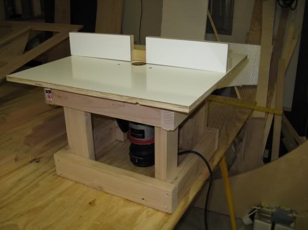

Postby planovet » Mon Feb 07, 2011 3:29 pm
All my cabinets are Red Oak and I used a router on all of them. Go steady and you should be fine. If you bog down, that's when you tend to get the black marks. They will usually sand out though!
I built a homemade router table to help with the thinner pieces. It made a world of difference.

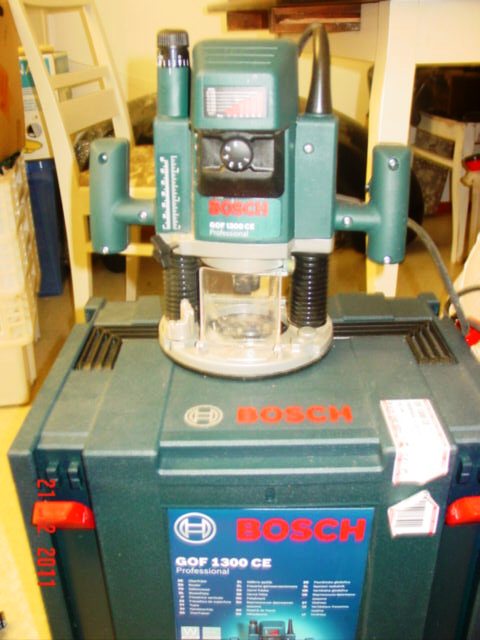

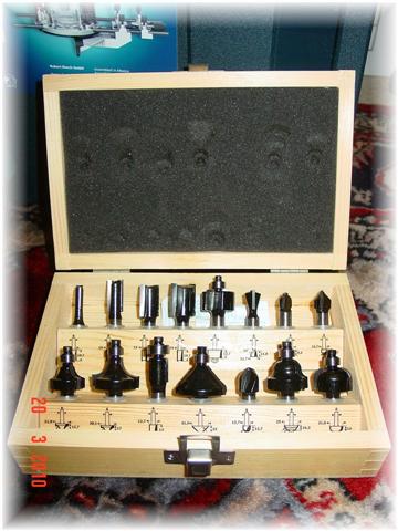

Postby Classic Finn » Sun Feb 20, 2011 6:18 pm
Here,s our Bosch Router and the Bosch Bits we have.
