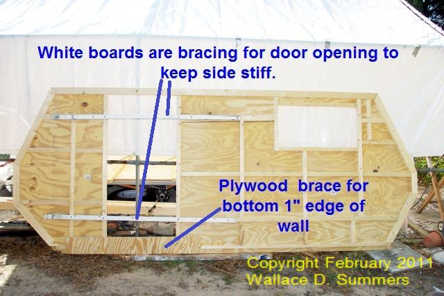

Postby bobhenry » Tue Feb 08, 2011 7:46 am
You just didn't look real hard......
Exterior osb skin was left intact as a shear member and 1x3 and 1 x4 were added at floor, door framing , galley walls and outside perimeter. This 1 by material was used as nailers for the inside paneling after wiring and insulating. The 3/4 void left enough room for 1/2 depth carlon electrical boxes for the electrical wiring.

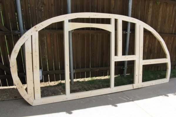

Postby planovet » Tue Feb 08, 2011 9:05 am
Cdash wrote:While looking through all the builds here, I have noticed that most people that build up walls for insulation seem to use 3/4" plywood as the framing and cut out the pockets/areas for the insulation. Why is this?
My initial thought was to use my outside ply (3/8" since that is the thinnest I can find in 4x10) then use 1x2's screwed and glued to the skin as studs/framing then the inner skin would be glued and attached to the framing. I don't see this done, except in the cases where someone frames the trailer up before skinning - similar to stick building a house the old fashioned way. Is is necessary for stength, or just a build preference?
Just a build preference.

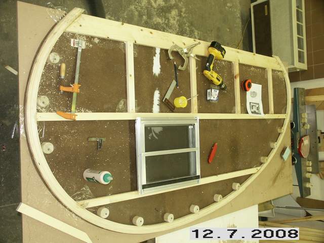

I built mine with inner and outer skins attached to a 1x4 frame. Built the entire wall off the trailer, finished both sides and then attached all 4 walls at one time. Worked for me.

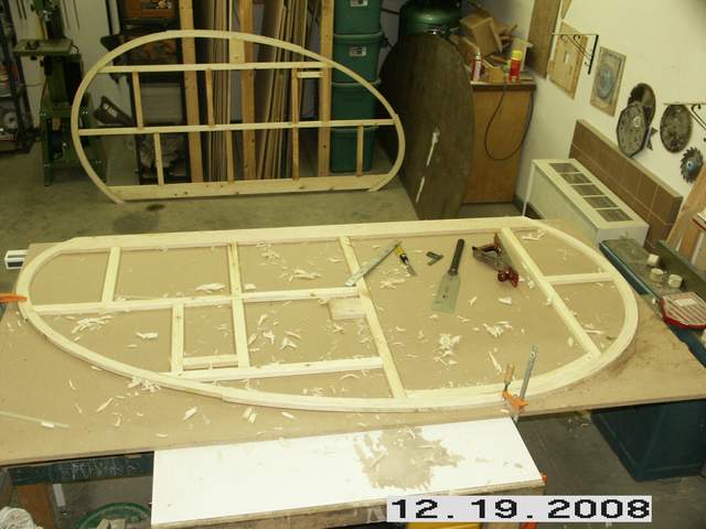

Postby Rock » Tue Feb 08, 2011 9:18 am
Mine similar to Planovet's. Built in this order only because that's how Mike did it in his original thread and I didn't see any reason to change.

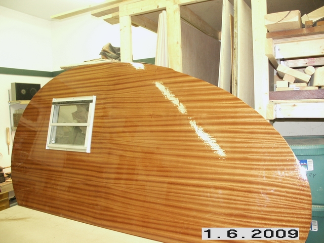

Here's one more stick frame using 1x for framing, then insulate, and skin both sides before mounting to the floor. I've seen people do it a lot of different ways by searching their albums. Lots of good ideas to be found there.

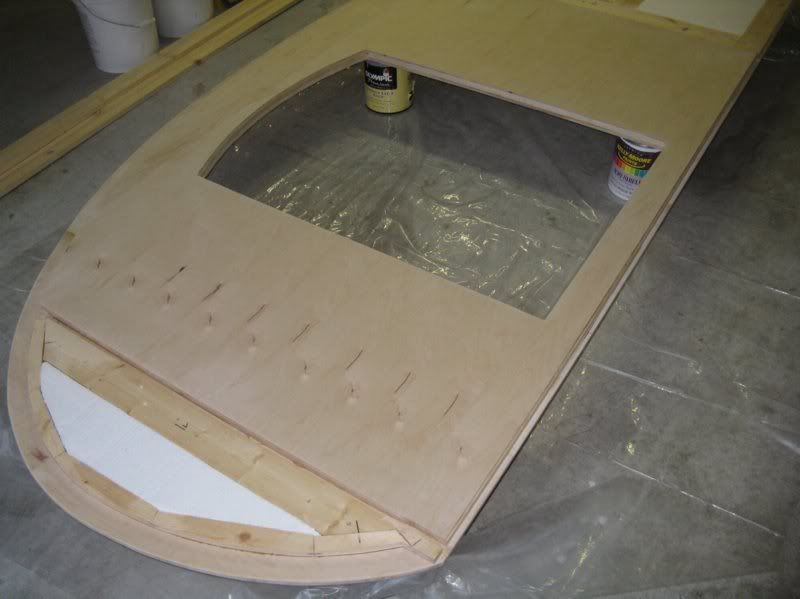

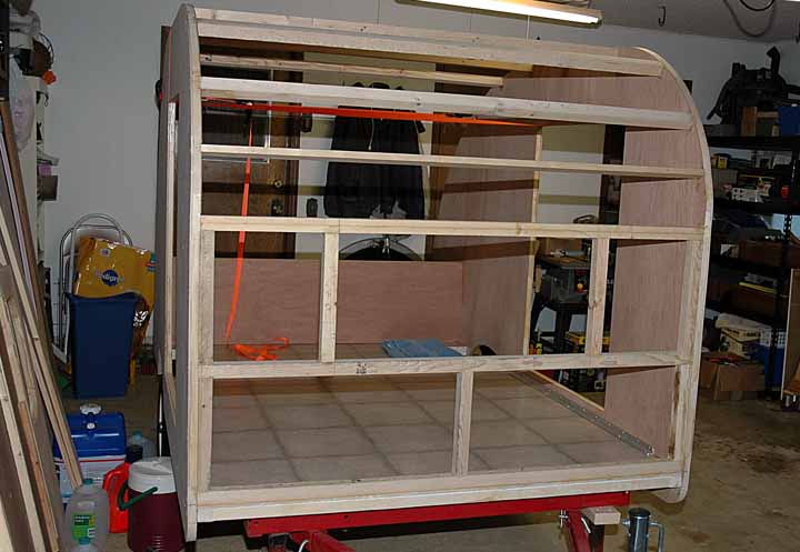

Postby aggie79 » Tue Feb 08, 2011 11:41 am
As others have said, either way works.

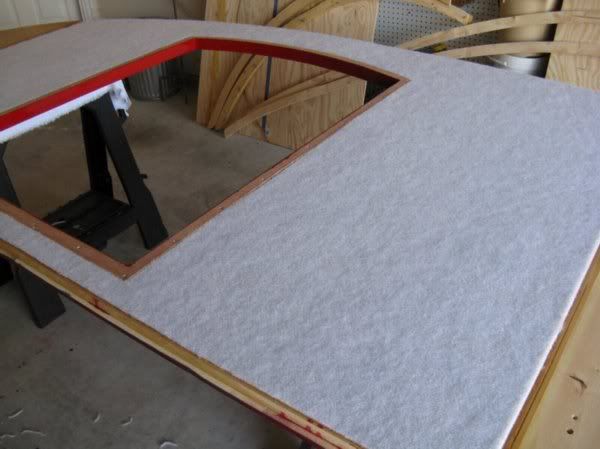

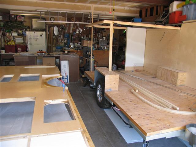

I guess my teardrop is a "hybrid". I used 3/4" plywood (actually MDO) for my sidewall framing. My insulated floor, roof, and hatch were stick framing.
Here's the floor:
This is a sidewall with interior finish material applied:
This is everything assembled (except the hatch) prior to adding insulation to the sidewalls and roof.

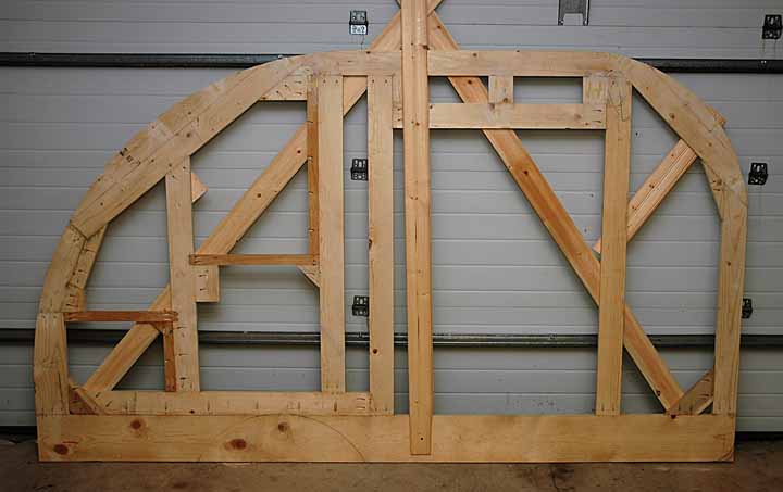

Postby bdosborn » Tue Feb 08, 2011 9:29 pm
Sticks! Lots and lots of sticks!
Then I skinned the walls and attached them to the trailer.

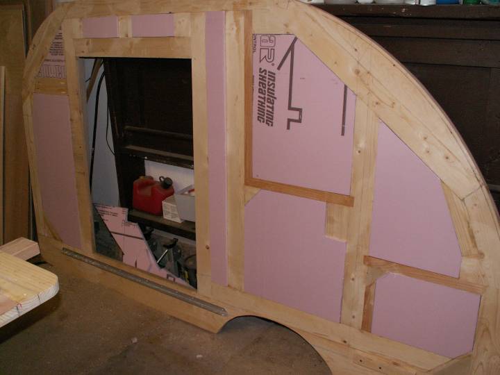

I may as well throw my pic up too. I used 1X wood with rigid foam insulation.
