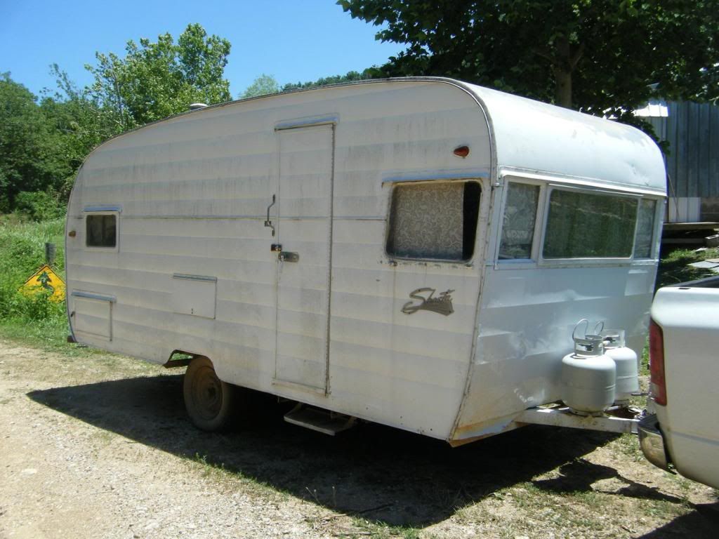

here is what I am doing,
1st, I know this camper really does not fall into the catagory of what most here build, however I have found a ton of good info here, with custom ideas and styles, as I am redoing this camper with a more modern design, rather than going back to all vintage stuff.
I am wanting to go from this
to this (photoshoped)

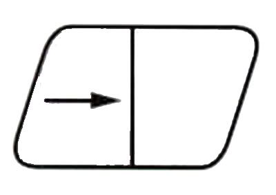

Postby universal_exports » Tue Jun 28, 2011 10:12 pm
no they dont need to open,
I'm looking for windows like this, that are slanted or angled or what ever you want to call it.
I've found a company that makes them but they make each one to your specific sizes and shapes needed, probably high dollar.
universal_exports
Posts: 51
Joined: Wed Jun 15, 2011 10:20 pm
Location: Searcy, Arkansas
Postby dh » Wed Jun 29, 2011 3:11 am
Austin hardware sells rubber window gaskets in varrying wall thicknesses. Just cut out plexiglass windows the shape you want, cut out the hole, put in the gasket, put in the plexiglas, done. A lot cheeper than a custom built window. I saw a thread on it a few years back, might try searching for it.

Postby universal_exports » Wed Jun 29, 2011 9:40 am
sweet, that is what I'm looking for although I will probably use real glass, I got a friend in the business, so I can get a deal on getting the windows cut.
