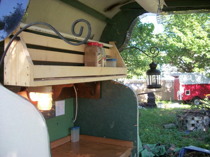

I hope the resolution on your computer is better than mine. If you can see the counter top in this pic it is the inside panel in a large prefinished cabinet door. I carefully sawed off the rails and stiles and used them for the back and side splash as well as a support leg.

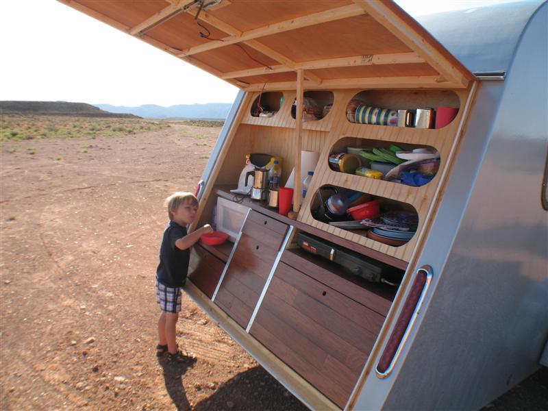

I used pre finished man made hardwood flooring (1/3 " thick) and glued the tongue and grooves together. Very light and strong.
I started at the front of this table and finished it at the wall. In the photo it is only partly finished.
I used it on more than table tops.
