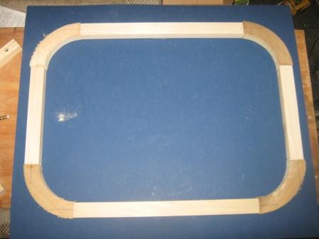

Postby 3822sean » Sun Sep 11, 2011 4:41 pm

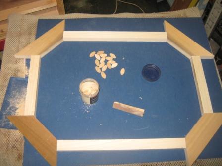

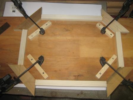

the rails are 1 1/8 wide im using r3 biscuts they are about 1" long,ImageImage,screwed some cleates to a piece of ply to use for clamping,Image

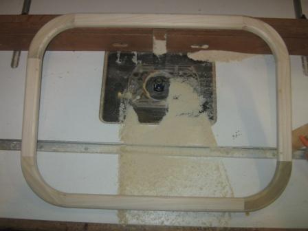

marked radius rough cut with jig saw,Image

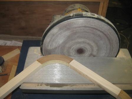

sanded out side,any sander will work ,belt,1/4 sheet,random,Image

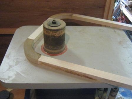

sanded inside, drum sander on a drill press will work,Image

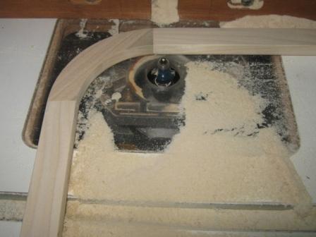

router with 1/4rad and a little step,Image thats it ready for some paint,Image hope this helps somebody

Whenever I build something like that, I make a Masonite pattern first. After building the part and roughing it to size, I stick the pattern on with double faced tape and trim it with a router and a pattern bit. Of course, if you're only making one piece, then it makes little sense to make a pattern first

Nicely done, how about some pics of it installed?

Postby 3822sean » Mon Sep 12, 2011 3:45 pm
sure ill post some pics when they are installed,have one more to do about twice that size
