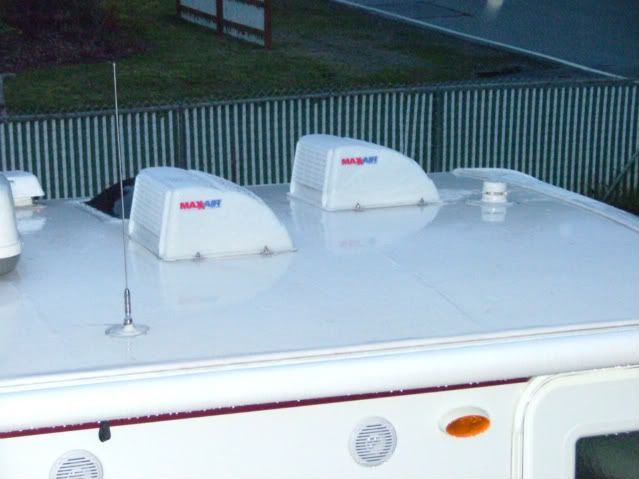

Postby wa_flyfisher » Wed Sep 21, 2011 3:41 pm
Yes, the adhesive is what you attach the rubber to the wood with.
Use the stuff in the tube for around any roof penetrations (screws, vents,etc.)
Here is the roof of my trailer
You can see around the antenna, the tank vent and skylight the tube dicor was used.
