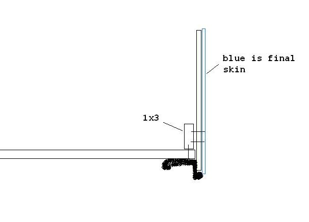

Postby bobhenry » Thu Sep 29, 2011 6:53 am
I looked at this and decided the floor might roller coaster a bit so I chose to use a good straight 1x3 - 1x4 as a cleat to keep the floor straight and add strength to the wall. The 3/4 inch void created allowed me a place to run my electrics and install a layer of 3/4 blue foam insulation.
Before you put on the final skin a very liberal coat of fence post goop or bed liner or other heavy bodied glop of choice will add the weather protection you are looking for.
