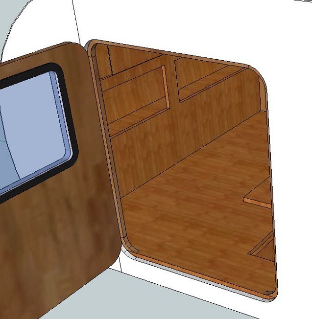

Here's what I'm doing. Although I haven't started making sawdust yet.
