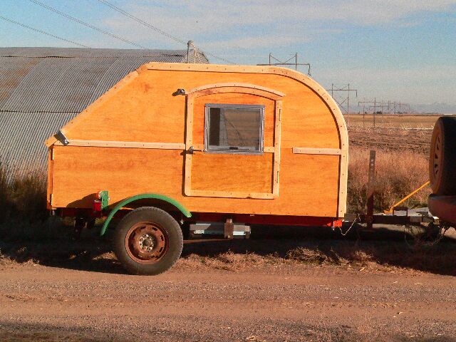

Postby Wolffarmer » Mon Nov 28, 2011 10:54 am
I made mine to go on rough and no roads.
Those are 13 inch VW wheels. Not the best for roughing it but so far is ok. I have yet to touch the frame/body to rocks or ground. ( not counting brush and trees ) I have had it in a few places where it was a rough and slow going in 4WD Low Range. But it does stick up in the airstream where it spends most of its time. Air suspension would be nice.
Randy
