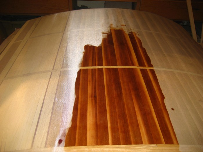

Postby Jim Edgerly » Sun Dec 11, 2011 9:40 am
I used 3 coats of epoxy resin, without cloth, then followed up with 3 coats of spar varnish.

Postby afreegreek » Tue Dec 13, 2011 4:21 am
until you have significant experience using epoxy as a base for bright finish on wood you are much better off sealing the wood with a coat of thinned epoxy first.. there is noting that will show sanding scratches and bruises on wood better than epoxy will.. the softer the wood the more this will be apparent.. woods like pine and cedar are the worst but even harder woods like cherry and walnut are suspect.. epoxy is a 20x magnifying glass for imperfections in the prep job..
that little spot you bumped, the spot where your clamp block crushed the wood a little, the one you THOUGH you sanded out.. ya, that will show up like a spotlight on a dark night the moment epoxy hits it.. this means you live with it or pull the cloth and throw it in the garbage.. it's much better to find these first then fix them before you blow $300 in glass and resin.. plus you will avoid other problems like insufficient wetting and off gassing..
