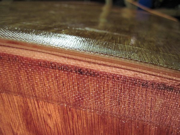

Postby StPatron » Wed Dec 28, 2011 2:41 pm
I radiused that area and was pleased with the results.
