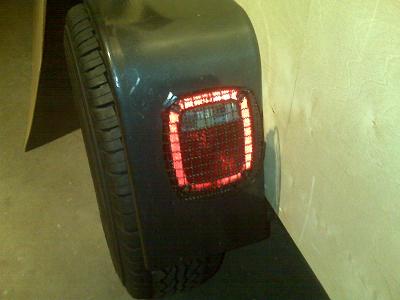

Postby Forrest747 » Fri Jan 20, 2012 1:54 pm
I currently have teh fender flush up against the body of Charley. This leaves teh wheel sticking out about an inch inch half. so i was thinking about putting spacers between the fender and teh body helping center the fender over teh wheel. Is it ok to have a space between fender and the body or should i attempt to fill it in with plywood backing or something else.

Postby parnold » Fri Jan 20, 2012 2:18 pm
My personal thought would be if you try to rig something up, it will look rigged. Just use spacers and let the gap be there.

Postby Forrest747 » Fri Jan 20, 2012 4:13 pm
I like that Jon, that looks like the way i may go. I could also make the top of the space a little higher than the fender and make it an attachment point for one end of a table.

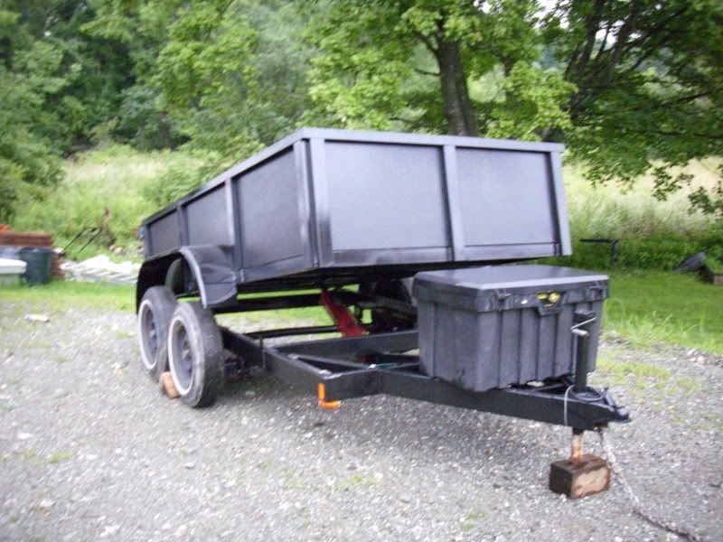

Postby dave_dj1 » Sat Jan 21, 2012 9:35 pm
This past summer I built a tandem axle dump trailer and I have my fenders spaced out from the sides 1 1/2". I like it because I can clean behind them instead of having crud and road crap get in there and cause things to rust prematurely.
