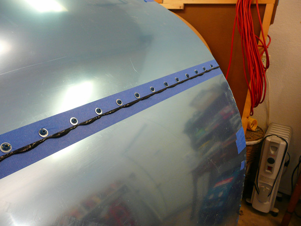

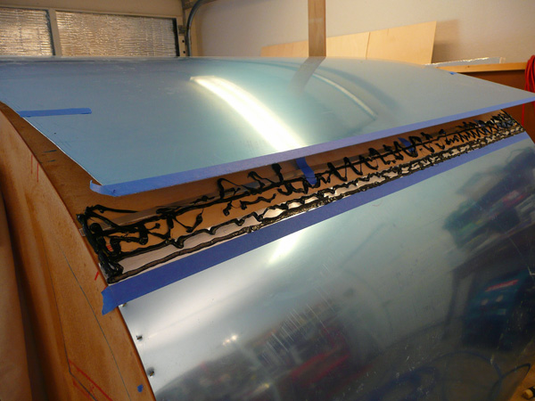

I overlapped my aluminum using lap joints with 3M 4200 adhesive/sealant between the sheets. I have one seam at the front of the teardrop, one on the roof, and one on the hatch.
The seams are located at the spars. I used some temporary screws to hold things in place until the adhesive set. The screw spacing is 3" on center.
Later, I removed the temporary screws, injected the holes with 3M 4200 using plastic syringes, and then installed permanent stainless steel washer head screws. I don't have a good picture of this. Here's the best one that I have.
