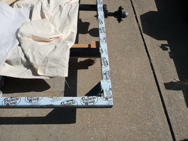

I wrapped the painted frame with window flashing.
Then I attached the insulated floor floor to the frame with stainless steel self-drilling, self-tapping trailer deck screws. (I did pre-drill holes to prevent the stainless steel screws from shearing off.)
