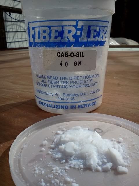

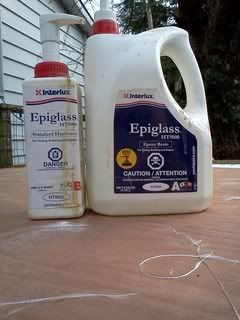

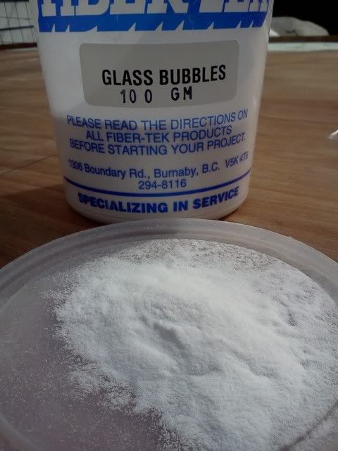

Some reference pics I thought might be handy:
This is the resin I use most. It's runny so it wets out really well but it can suck up a lot of filler - good thing filler is cheap !
That amount of resin was about $150.
This is cabosil, a structural filler. This is a fibrous powder that makes the strongest epoxy adhesive you can come up with. It can be combined with other fillers to customize your adhesive, but should be added first since it takes a fair bit of resin to wet it. Those clumps are from the rough 'hooked' ends of the fibers that do the job, once it's stirred in it blends smooth. If you are using a lot of it, wear a dust mask as it's an irritant and you'll be sneezing for sure. This pot was about $7.
Microballoons are tiny glass bubbles that break when they're sanded, which makes them an excellent fairing compound. Being mostly air, the compound is lightweight and easy to sand. The texture is identical to flour. Again, about $7 for that pot.
