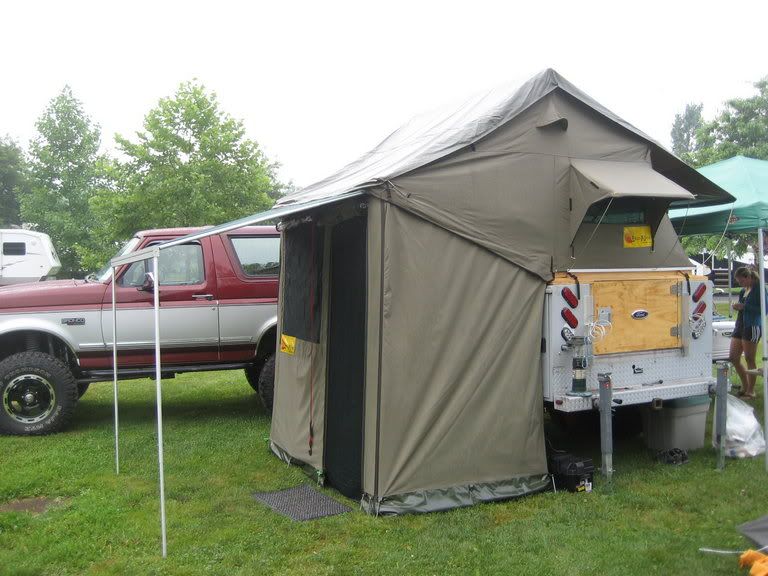

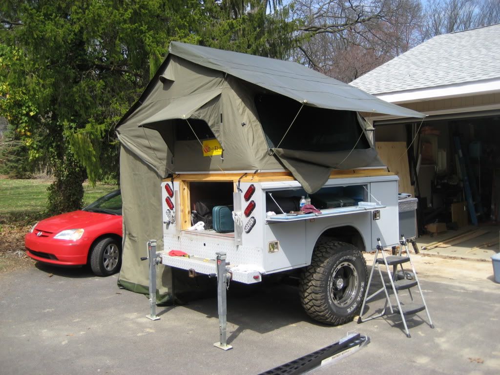

I say go for it... Just make the modifications necessary to make it work...
Don
Truck: '96 Ford Bronco, Modified for off-road stuff
Trailer in progress: Not a tear drop exactly, sort of a mut of a couple different designs.
