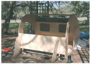

Postby TRAIL-OF-TEARS » Thu Sep 22, 2005 9:47 am
I built the body then put it on my frame (I moved the body onto the frame by myself). I have no sub floor and I use 1/2" cdx for the floor. I did use 1x2 poplar for the roof spars.
