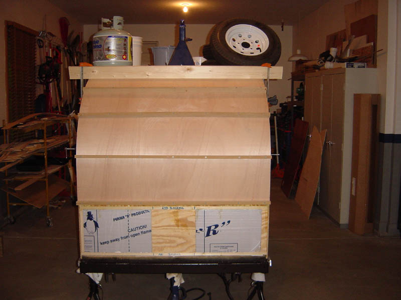

Postby BILLYL » Sun Oct 02, 2005 5:07 pm
Steve-
Worked like a champ!!!!!!!!!!!!!!!!!!!!!!!!!!
Took all of 30 minutes to install - am only doing one layer of ply. I also added a board at the bootom to act like a shelve so the ply could rest on it and start the aggressive curve.
One other thing I did was to attach the ply on the frame a few days before - so it gets use to being curved under pressure. Let it sit for a few days and it began to think that it should be in that shape. That helped out a lot.
Thanks again
Bill

I took one end and glued it down with polyurethane caulk. I clamped it down with at 2x4 on end. It was either screwed down or held in place with a floor jack (the weight of trailer clamping it down.) When it was dry, I removed it and started bending it over the curve. I pulled it with straps while the same board clamped the other end. I would also put screws into it to hold it down.
