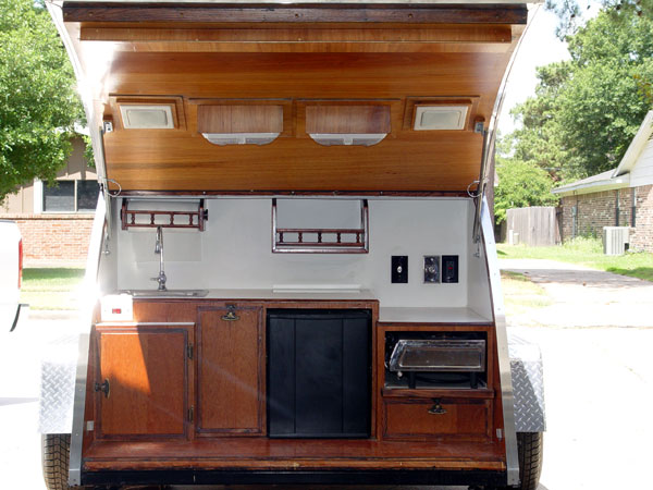

Postby randy chesnutt » Thu Oct 06, 2005 5:24 pm
from right to left i have my pull out stove from htf and below it is a pull out drawer 12x24. nexts is my 12 v. ice box and nexts to it is another pull out drawer that have all my pots hanging on one side and on the other side is shelfs for can goods. you can lock it out and the top has formica on it to make another work place.then nexts to it is my 10gal. water tank and 12v pump for when you are not hooked up to city water.the switch is above the door. there is a single sink.above the sink is the paper towel holder next to it another shelf and below the shelf on the counter top is a plex-glas lid you push down on and the lid comes up and you put your bread in out of the way on the back wall above the stove is the switch for the ice box.110vac gfi and 12v on the hatch i have two lights set on boxs that makes the lights level when hatch is up and nexts to them on each side is my drop down speakersi like my galley, no regrets and change
