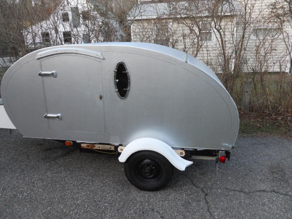

I built mine out of strips of plywood cut with the curve and glued up edgewise. I mostly used a 4" angle grinder for fairing. Then I laid a coat of fiberglass on the outside and more fairing. I did not finish them to a terribly high standard because truthfully I made them a little too small visually. I was coming from a motorcycle mindset where the front fender nearly rubs the front tire but travels with it. Quite different from a trailer. I may redesign and tr again or I may save that for build #2! Good luck. It's very doable.
There's a few pictures of their construction here
viewtopic.php?f=50&t=49965
