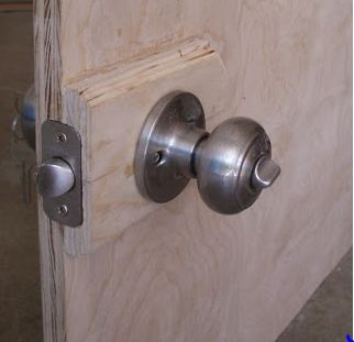

Postby pohukai » Wed Feb 20, 2013 9:42 am
I used regular door handles from Home Depot (I think $8.00 each)

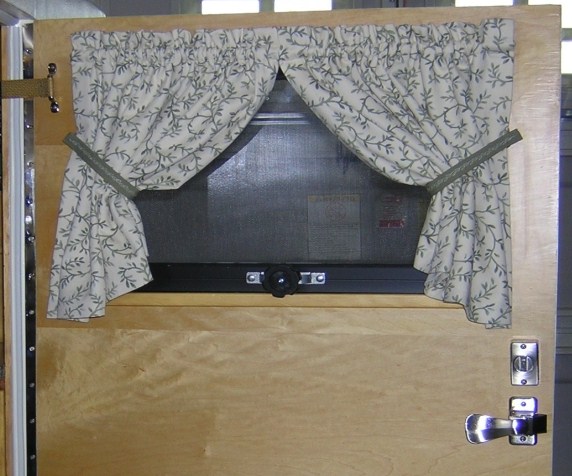

Postby bobhenry » Wed Feb 20, 2013 10:40 am
You have to look thru to see the national hardware slide lock on the far door.
These are great for simple surface mounting and they have a turn knob to assure the slide is not slipped open by accident if you choose to engage it.

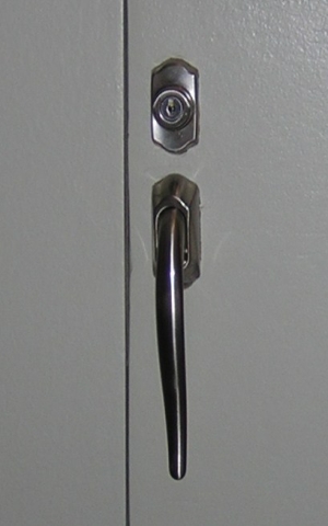

Postby grant whipp » Wed Feb 20, 2013 9:43 pm
Depends on how fancy/elaborate or how basic/KISS you want to make it. For traditionality and reliable simplicity with both outside and inside security, it's hard to beat the simple outside locking L-Handle with lockable inside door latch: http://www.lilbear.teardrops.net/parts2 ... oorhandles
