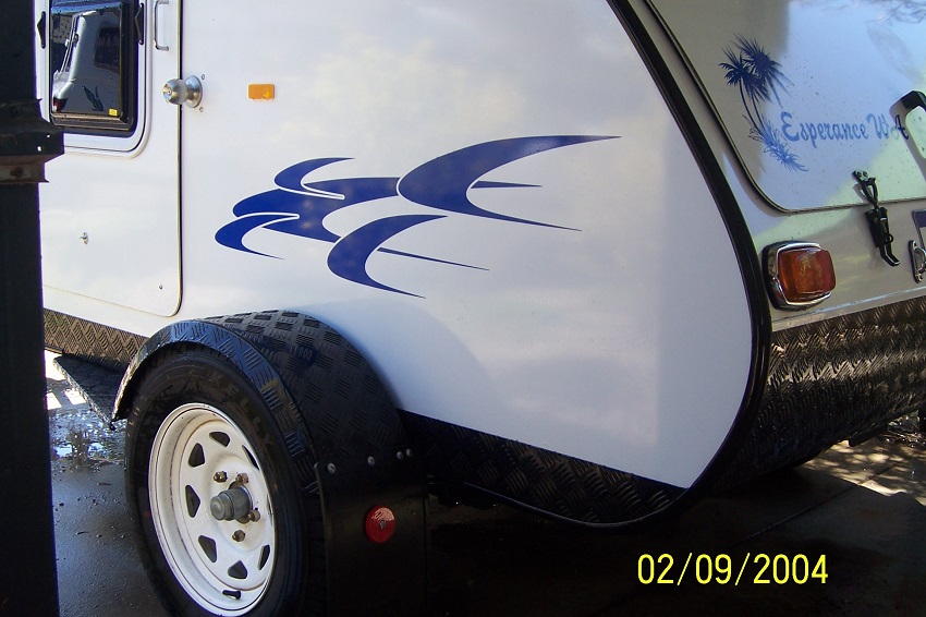

We used a plastic moulding supplied by a caravan parts supplier.
Easy to bend.

Roo Dog wrote:Irving,
Easy to bend.
RD
Excellent. Thanks for the info and the picture. Looks great. Have a website or a source where that is available from?
