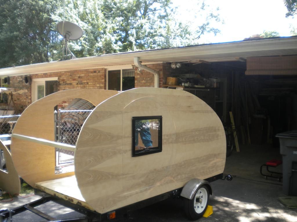

I've started on my teardrop. So far it is going well, and I like the design I made.
Here are some images of it so far:
I've run into a problem. I bought 1/2 inch plywood because they were out of oversized birch in that thickness. I'm having trouble finding hinges/seals for the door and hatch. Seems like everything I find is made for 3/4 inch ply.
Does anyone know of a solution for this problem? I considered lining the doors with strips of 3/4 inch metal, or putting some kind of 1/4 inch wood paneling on the whole inside.

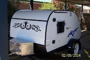

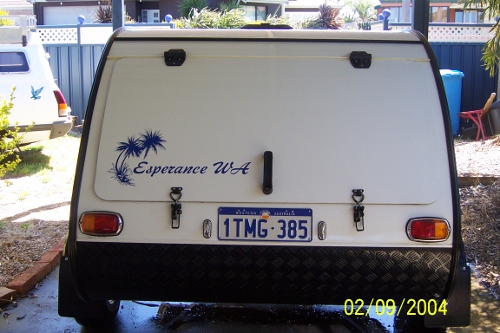

Corv,
We used external hinges and flat seals as the door(s) are external mating.
RD
