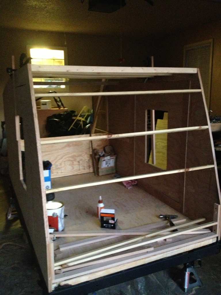

I am about half way through my build and putting these 1x2 spars across looks awfully flimsy and has me concerned!
I used 1x2 mostly and at the front top corner and where the hatch attaches I am using 2x2.
After everything I've done so far this feels the most unsure I've felt about building. I started to just use 2x2's all the way around. Anyways any comments tips or suggestions?
Oh the Ty Dean plans that I am call for little 1" blocks on the sides of the spars but it seems so useless.

Once you put the skin on, it will stiffen up alot. And those blocks between the spars do help by adding the surface area of the joints. I plan on running those blocks all the way from spar to spar on my build.

you can always increase the number of spars. My camper is 64 inches wide and I used 1.25 inch spars spaced about 10 inches apart. The roof is plenty stiff and I don't even have the interior skin on yet.

Is that a four or five foot span? For a four foot, I think it's fine. Maybe double up if its five. When you go to staple, have some shine a bright light on the outside and you should be able to see the spars through your ceiling. I used 2x2 oak for my hatch attachment spar.

You can clamp another doubler on each spar right now and glue with tite boned 2. I stapled my ceiling (1/8" birch) to the ribs outside on a sunny day and the ribs were easy to see in the dark interior. Otherwise cut a 12" guide stick to help you measure inside from one stapled spar to the next unstapled one. Doubled spars are going to be much easier to hit.

Are those true 1x2's (3/4 x 1-1/2 actual)? They look thinner, like furring strips. I would be concerned about the large knots creating weakness.
To aid in accurate stapling, before putting the skin on, mark the location of the centers of all of your spars on the outside of the walls, both sides. Then when you go to put the skin on you can string a chalk line from side to side giving you an accurate guide. Just a thought.
One more thought. If you double the spars you probably don't want to staple directly down the middle right into the glue seam; try alternating on either side of the chalk line.

No they are not true 1x2's. more like the 3/4x1.5!!!! I didn't think you could get true1x2's and when I did they were soft pine and I had trouble with them splitting. So I guess I'm going to make these spars work now. I've doubled a few of them to help make sure I get some staples or nails in them.
