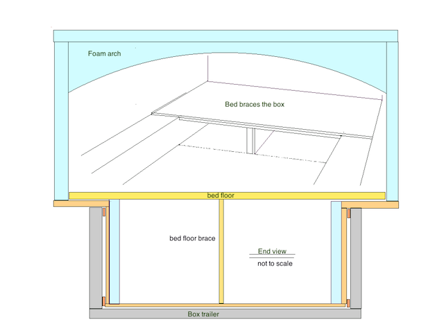

Good day all,
My question for those that don't want to read all of the below dissertation: If I build a 5' wide x 10' long tear without a rear galley, but with front cabinets, will it be too flimsy due to the lack of lateral/horizontal bracing? I plan on 3/4" solid walls and an insulated roof (ply, spars + insulation, ply) and a Benroyish type shape or a Jim Dandy shape, therfore the roof will be a solid piece (scarfed ply) from front of trailer to rear of trailer.
Long version:
I have been pouring through these forums off and on for the past couple years, asking a question every now and then. I have learned that if I don't jump in, I many never build one of these things, I could literally plan and design myself into a corner. So my plan is to keep things simple, real simple.
My main use for this will be to pull behind my Jeep to have a "bed on wheels" when I take trips to off-road with my Jeep. I don't expect to pull this thing through he!! and back, but more along the lines of drop it off at the campground, go out and have Jeep fun, then come back to camp - NOT off-road capable. I have been tenting it, so I am pretty used to the simple life when I do these trips. Hence, I've decided that I don't want to build a hatch for a kitchen - at least not on this one. I am fine with setting up my kitchen on a portable table and using a cooler (or maybe someday adding a small fridge to the mix some day).
What I am thinking is no hatch, no kitchen. Mattress (designing around a queen size to fit my height and allow for 2 kids) would go all the way to the back of the camper and would have some cabinets up front and some empty floor space for storage (or potentially another kid). Planning on doing a 5' wide (inside) x 10' long. I would have 80" long mattress, ~12" front cabinet depth leaving about 24" floor space for storage room/additional sleeping room.
Planning on solid 3/4" walls, manufactured doors, insulated roof, insulated floor and home build frame of 2x2 tube steel and a torflex axle. Shape is either going to be a Jim Dandy shape or similiar to KCStudly's (if he'll be nice enough to let me borrow his shape) http://tnttt.com/viewtopic.php?f=55&t=48630
With all this said, Is the lack of galley cabinets going to harm the overall stability of the box since it won't have the diaphragm to stiffen it side to side?
I'm sure there will be a plethora of other questions, but want to make sure my idea isn't fatally flawed before starting.

Postby angib » Tue Sep 24, 2013 4:11 pm
Cdash wrote:With all this said, Is the lack of galley cabinets going to harm the overall stability of the box since it won't have the diaphragm to stiffen it side to side?
No, the fixed rear roof skin will provide all the stability that the galley bulkhead provides in other teardrops.
The one thing you lose is the direct support from the frame through the galley bulkhead to the sidewalls - that's no problem if your frame is the same size as the body, but if you were going to overhang the body beyond the frame, you would need another source of strength.

Postby RandyG » Tue Sep 24, 2013 8:53 pm
You can still get the torsion strength back by the bunk bed being where the galley would be.

Postby KCStudly » Tue Sep 24, 2013 9:00 pm
+1 what Angib said^^. The rigid rear roof structure with curved surface should do it if you aren't overhanging the sides of the frame. If you are overhanging the frame you will want to be sure that the rear sill lands on frame (maybe even add a 1x6 kicker down low in the back if using the Jim Dandy profile). If overhanging the rear of the frame, add some solid side outriggers or use a longer rear xmbr to pick up the bottoms of the walls.
If you like, you could incorporate a shallow arch style gusset in the ceiling and part way down the walls without taking too much head room, ala GPW's foamy concept sketch here:
