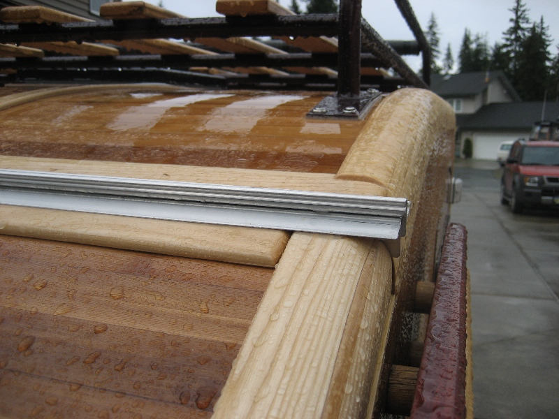

Here is my set up on the side wall using 1/2''nutserts, I just did not want holes on the roof.....
106214
106218
106276
Here now but Camping later.............Dan

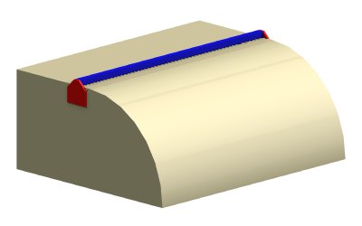

A 2x3 sounds right to me for lightweight boats.
Remember that what you need to do is connect the 2x3 to the sidewalls, not just to the roof. If in doubt you could epoxy a piece of plywood (maybe 6" x 6" and maybe 1/2" thick) to the outside of the sidewall and to the end of the 2x3 - that way, the load goes through the plywood not through the end of a roof spar under the 2x3.
It's a question that's been asked before, so I even have a ready-made graphic of the (red) piece of plywood on the end of the (blue) 2x3/roof bar.
