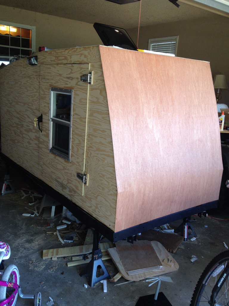

Postby tscarbroughdc » Sun Dec 08, 2013 3:50 pm
I applied the first coat of CPES today to the Luan on my benroy camper. It was more liquid than I thought that it would be while applying it. Is it supposed to be liquid or more like a syrup?
By the time I finished applying it, I noticed that it was getting sticky so I guess I applied it right.
I'm planning on 2-3 coats to the Luan only. I planning on only painting the 3/4" plywood sides and NOT applying the epoxy to the sides. Does that sound ok?
tscarbroughdc
Posts: 120
Joined: Thu Apr 25, 2013 6:37 pm

Postby Micro469 » Sun Dec 08, 2013 11:06 pm
tscarbroughdc wrote:I applied the first coat of CPES today to the Luan on my benroy camper. It was more liquid than I thought that it would be while applying it. Is it supposed to be liquid or more like a syrup?
If you are using CPES apply to your sides as well. It's a penetrating epoxy, very liquid, and seals the wood very well.
