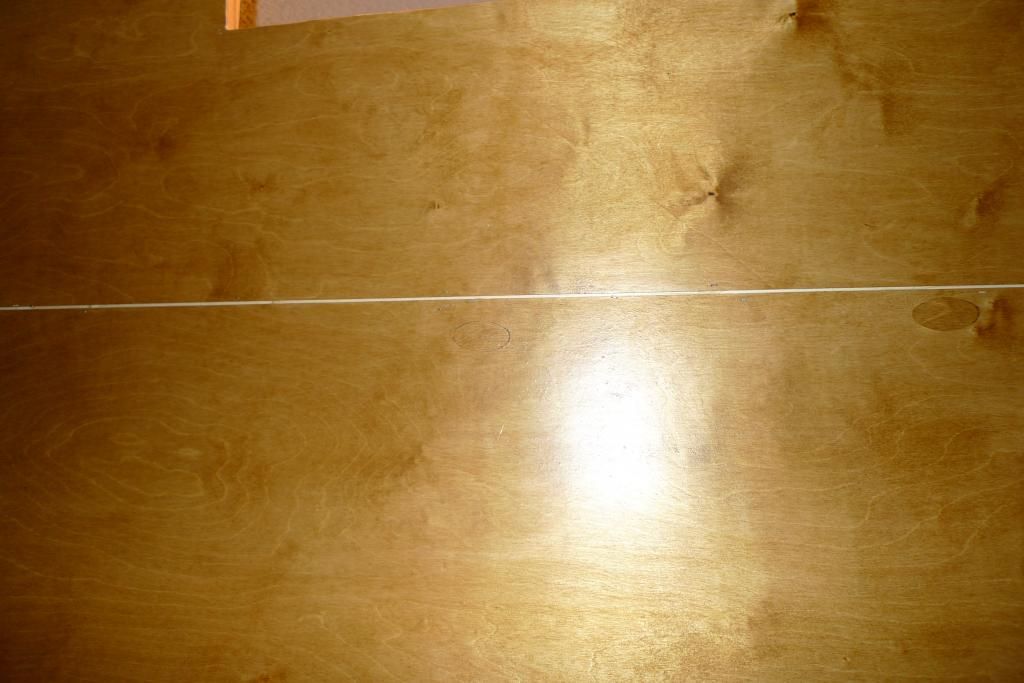

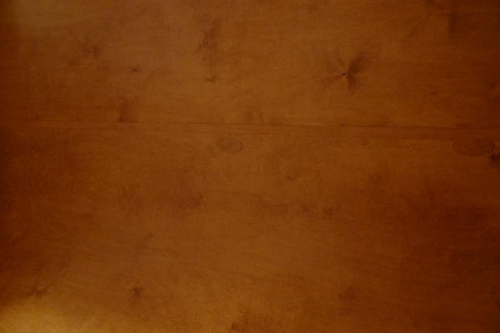

Postby Campin' Texan » Wed Nov 20, 2013 10:16 pm
I used this real wood veneer. It stained to match my birch perfectly. It comes in a couple different types of wood. The iron on adhesive has held up great. I had a small gap between sheets of plywood on my ceiling. This worked great to cover the gap and cover nails. Here's some before and after pics.
before
after

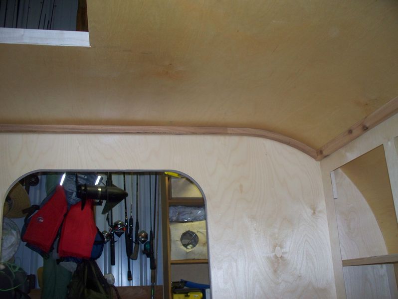

Postby rowerwet » Thu Nov 28, 2013 7:43 pm
rowerwet
