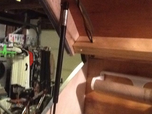

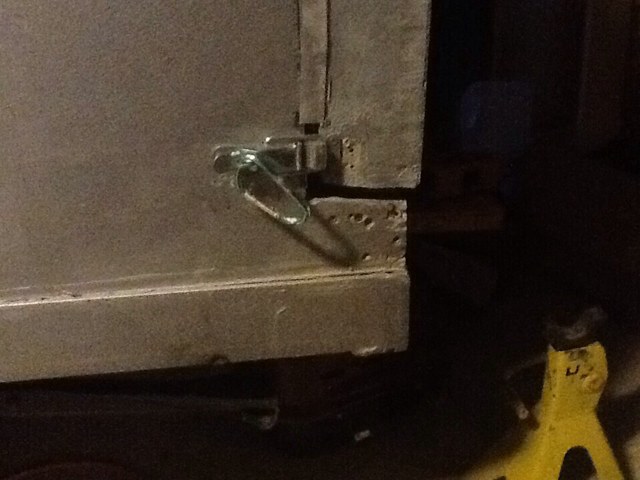

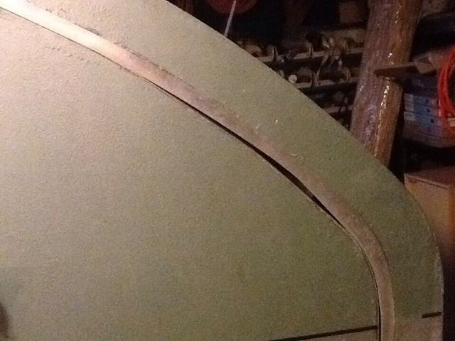

The PO of my TD cut the galley hatch after putting the roof supports in place. He didn't have cabinets, so once I put in cabinets, the walls squared up slightly, but the hatch didn't. The end result is about 1/2 inch gap in some places. Any ideas on how to close it up, short of making a new hatch?
Here are some pics to helps understand my issue. The ribs are 2 1/2 with about 3/4 space below them.
Thanks for any ideas

Postby KennethW » Sun Jan 26, 2014 11:17 am
I am know I will be corrected if this is a bad ideal. I would use plastic wood filler. Use oiled wax paper as a release and a spacer to form the filler space when the hatch in closed.

Postby Micro469 » Sun Jan 26, 2014 1:48 pm
Take the metal trim off your sidewall, and laminate strips to the edge.Then sand a new curve to match your hatch and replace the trim. You will have to touch up the paint on the side tho.
Oh, and the area where your hatch curves (by that black line) , the wall might need to be sanded down so the hatch closes closer near the bottom. At least that's what I see looking at the pictures......

Postby Socal Tom » Wed Jan 29, 2014 9:50 pm
So I've been looking and analyzing. The top of the hatch lines up well with the body. The bottom of the hatch aligns well with the bottom of the body, though there is a pretty good sized gap between the bottom of the hatch and the uncut section. I think this shows in one of the pics. I think that the issue is primarily that the cut between the hatch and body is too big. It may have been exacerbated in some areas by additional sanding when I was trying to make it tight without any gasket material. Now that it is aligned better the over sanding is more evident. A combination of building up the body and the wider trim maybe my best bet.
Any advice on how to laminate more wood on?
