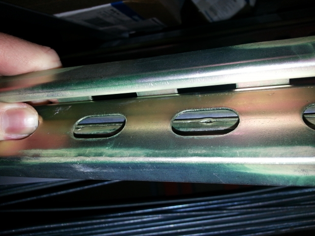

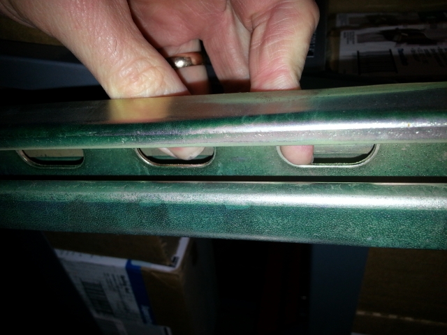

Postby Prototear » Thu Mar 06, 2014 3:34 am
I'm currently designing a small slide-out to hold a cooler out the side of the trailer so that we can access it without having to open the main hatch. This would allow us to load it when we set out on a trip and avoid removing the bikes hanging off the back that would block the hatch.
I've looked at heavy duty drawer slides but they are expensive and would limit me to just including one pair if I broke down and bought it. Instead I'm thinking of using the low profile superstrut and either rollers or flat plastic bushing.
To keep the option of having my cooler on the right or left I'd like a track that goes the full width of the trailer and helps to reduce other materials. My frame has 1" tubular square steel on the sides so I have solid attach points to use. This shows the rear left corner where I cut out tubing in the frame that seemed excessive to make room for the slideouts.
For the track arrangement, I have 4 ideas in mind, all variations of the same idea:
1. Using rollers similar to a garage door roller but slightly smaller to fit inside the strut, but its hard to find rollers the right diameter. I figure I'd need at least 3 pairs of rollers, one in front, one at the rear to react the upward force, and one about 3/4 of the way back as a pivot.
2. Use actual garage door track to fit the rollers, but this might be stiff enough.
3. With a second pair of superstrut tracks laying flat inside and sliding along the lower edge of the first pair, also serving as the frame for the slide-out tray. This needs a bushing on top of the second pair to fill the gap and react the upward forces when the outside of the slideout tilts down from the cooler weight.
4. Same second pair of superstrut tracks but with small rollers to fill the gap instead of a flat plastic bushing.
I checked these at Home Depot and was surprised that they fit together nicely and slid fairly smoothly, even with the friction of the full 10' lengths. Here are pictures I took in the store looking at what would be seen above and below (but I wasn't confident enough to buy 4 sticks yet so I took these pictures in the electrical aisle of the store). :roll:
For rollers in option 1, I've found one that would fit nicely, but at $17 each it would defeat the cost savings. These http://www.mcmaster.com/#additional-carriages/ are made to fit in steel tracks that have almost the same dimensions as the low profile superstrut. They are also steel and I think nylon may be quieter.
Garage door rollers are 1.75" diameter (or larger), cheap, and widely available but the superstrut has an inside width of 1.42 inches so I'd have to machine the wheels down and keep them round while doing it. I also wonder how much steel will be underneath the nylon once I start cutting or grinding into it. This led to option 2 with actual garage door tracks but I wouldn't be able to take advantage of the strut as a structural member like I could in #1, and I don't know if it would hold up the weight of the cooler cantilevered out the side of the trailer.
I also found an unusual steel garage door roller at 1-5/16" diameter that comes close and would allow for about a 1/10" of play, maybe too much play.
Options 3 and 4 are similar variations but require extra outlay on superstrut.
For now, I'll continue my search for the right size rollers to use in the superstrut, and maybe try to machine a cheap nylon garage door roller down to work. :thinking: If this works, I'm also thinking of using a second pair of tracks up higher to hold a slide-out sink/faucet, but I wouldn't be able to use it on the same side as the cooler since it would interfere, especially if I wanted to make it fit under a normal height countertop in the galley.
Steve
