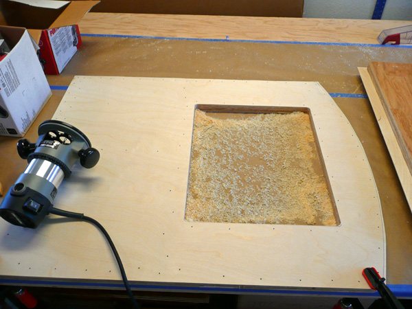

Postby skinnedknuckles » Sun Apr 20, 2014 7:42 am
I used a 5/16" x 1" straight carbide bit with a 1/4" thick luan template. Set my router up with a bushing that would just let the bit through the center and made 4 different depths of cut and came out with a piece that required very little sanding to get smooth. I did buy a new plywood blade for my circular saw but I am very happy with the results that I routed the sides, doors, window openings, floor pieces and am planning on routing all plywood parts the same way. :) I never have used my router as much as I am doing now, it sure works slick :)

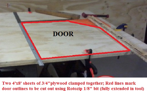

Postby working on it » Mon Apr 21, 2014 11:11 am
woodywrkng wrote:I win the prize for smallest bit, at 1/8", in a RotoZip. Such a small bit ensured a small gap between door and wall.
I used the same tool and bit, except that I cut out both doors at the same time... 3/4" stacked on 3/4" plywood.
DOOR CUT-OUT.jpg (60.36 KiB) Viewed 514 times

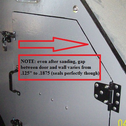

It was a bear to cut, and I had to sand both sides of the cut significantly (in some places) to "smooth" them out. Ended up with a variable width gap all around, from 1/8"+ to 3/32"+.
DOOR CUT-OUT GAP.jpg (120.13 KiB) Viewed 514 times

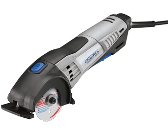

Fortunately, the automotive doorseal I used doesn't care! I would not repeat that mistake (even though I later cut out the holes for my windows and A/C, albeit from a single thickness of 3/4", using the same tool) I would probably get a Dremel Saw-Max,
if I were to repeat.

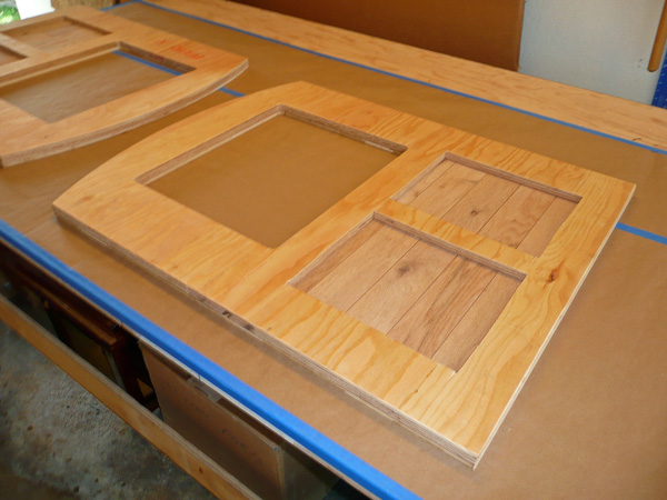

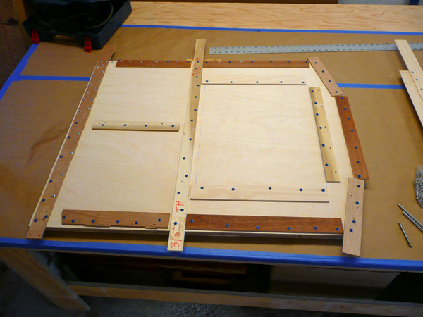

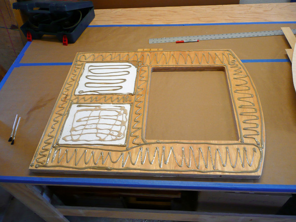

I used a router with a 1/4" solid carbide spiral bit with bushing and 1/4" MDF template to cut the plywood framing for the door. Tabs were left to keep door blank in place for interior wall finish.
The interior wall finish (5/16" pre-engineered flooring) was applied to the framing. Then I used a jigsaw to rough cut the door blank from the rest of the sidewall.
Later, I cleaned up the edges and door opening with a router and template bit and applied the exterior 1/8" plywood (after insulating the framing.)
The plywood was oversized. After the glue set, I trim the excess with a router and template bit.
