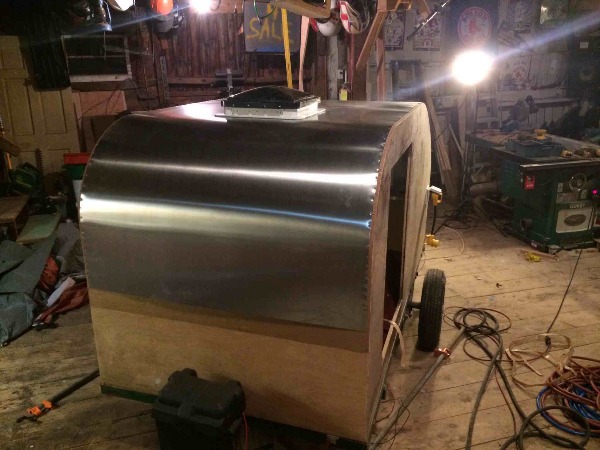

Postby Jdhiker » Wed Apr 23, 2014 9:29 pm
Here is the roof on. Diamond plate rock guard going on lower front....fantastic fan installed. Now need to order the moldings

Postby Jdhiker » Thu Apr 24, 2014 7:21 am
Have roof edge trim with insert type coming. Wide enough with the Rv tape under should seal fine, I measured and all the staples will be covered with plenty of sealed trim over.
Also going to have a diamond plate in the lower front.... I guess an aluminum trim with the sealant under to make the transition from roof to rock guard.
