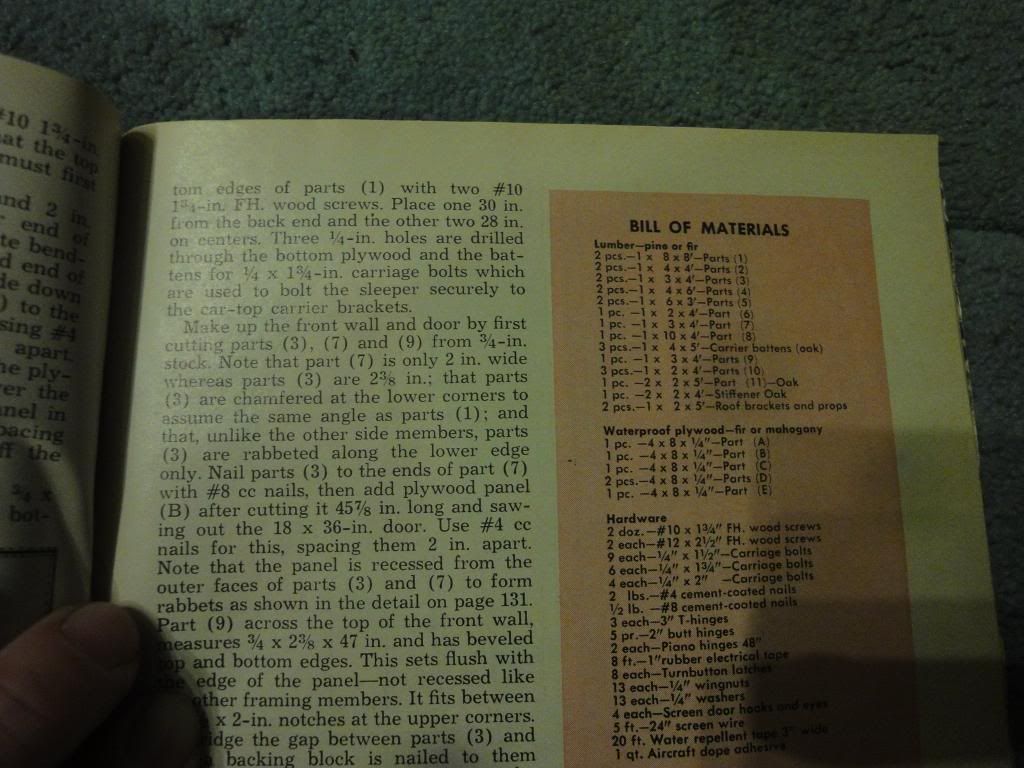

I once saw a set of plans on ebay from an old popular mechanics magazine from 1964 but the seller was looking for $20 dollars just for the copies of the pages. so it took a few months but i tracked down a copy of the full magazine for $1 from ebay in Canada.
I still havn't built it but i plan to one day.
I just took close up pics of all the instructions and plans...
click the pic above and it should take you to my photobucket so you can see the full set
I doubt it would still only cost £35 to build though :R
