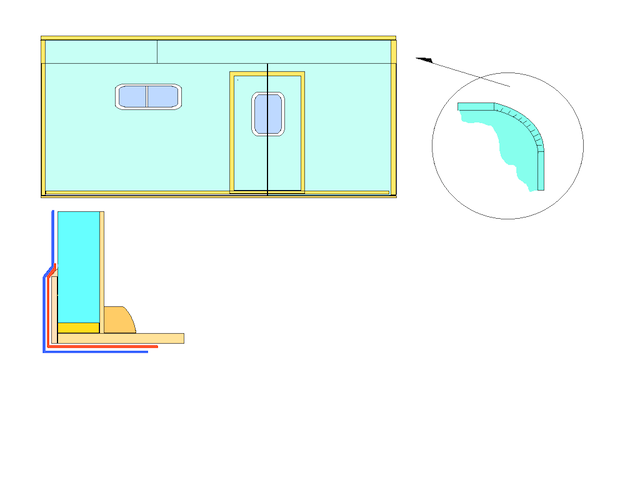

Postby KCStudly » Mon Jun 03, 2013 3:16 pm
The filler piece was more like a 1x6 plank surrounding the base of the cabin on two or three sides making up the difference from a 5 ft trailer to a 4 ft cabin. Knowing now that your trailer is only 4'-3" yours would be more like a filler piece or trim board.
GPW (hangs out on the Foamie forum) has quite a few concept sketches, and I think he had one that might work for you. let me take a minute to look...
Okay, here's the GPW sketch that I was thinking of..
IIRC he was just thinking up a way to reinforce the wall to floor join (Foamies use fabric saturated in glue or paint as a structural laminate and sealing method, similar to glass reinforced epoxy, only thrifty).
The wall he shows is thicker because it is foam (the blue) and the trim board is thin because it is wood (tapered tan), but you could reverse this. Use ply for your walls and a thick piece of foam tapered on top to shed the water; glue it on as a cover up and skin it with canvas and paint. So long as you have a decent cleat well fastened (the 2x2 on the inside corner) it shouldn't matter that much if the main portion of the side walls are not over the steel frame rails. IMO.
