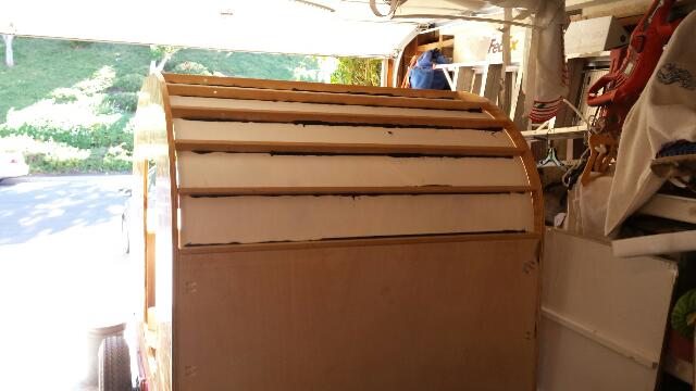

Postby Graniterich » Fri Nov 28, 2014 1:15 am
I Appreciate all the input, ended up using pocket screws and. and titlebond three. It is very solid
Graniterich
Posts: 508
Re: Spar to wall adhesive technique
Postby Graniterich » Fri Nov 28, 2014 1:17 am
Pictures
