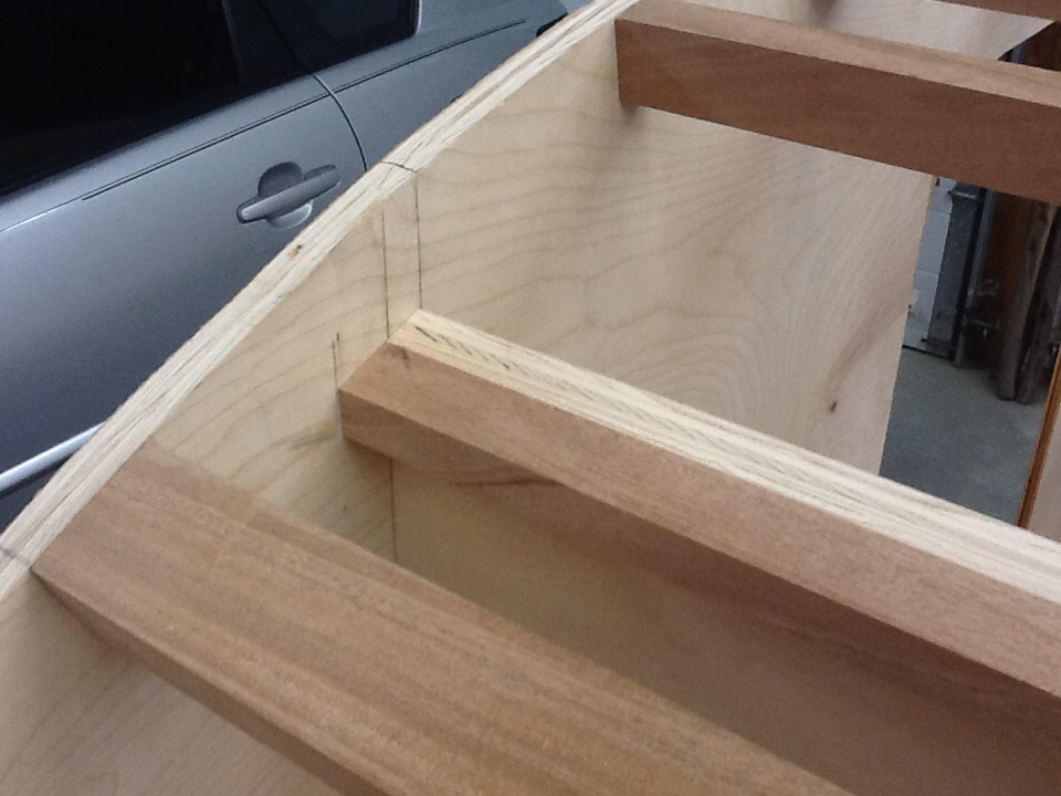

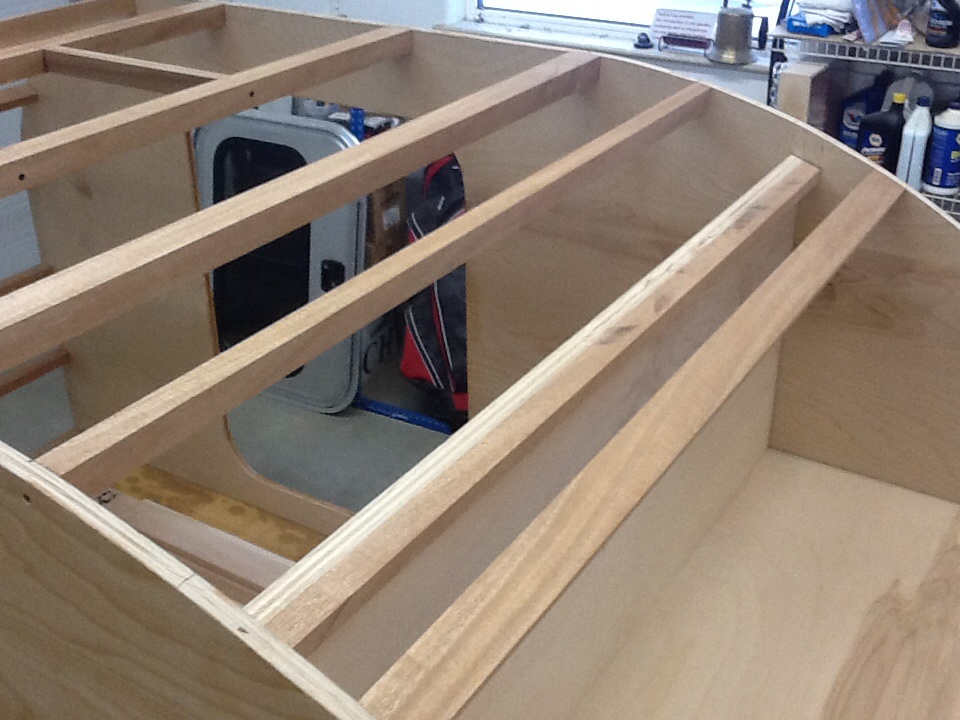

Postby ratrod71 » Tue Dec 02, 2014 12:02 am
I need some help with how the galley bulkhead wall meets the interior headliner. I imagine the headliner attaches to the bottom of a spar, then the galley bulkhead butts up to the headliner at the same spar. Am I on the right track? Anybody have photos? Thanks, Bryan :thinking:

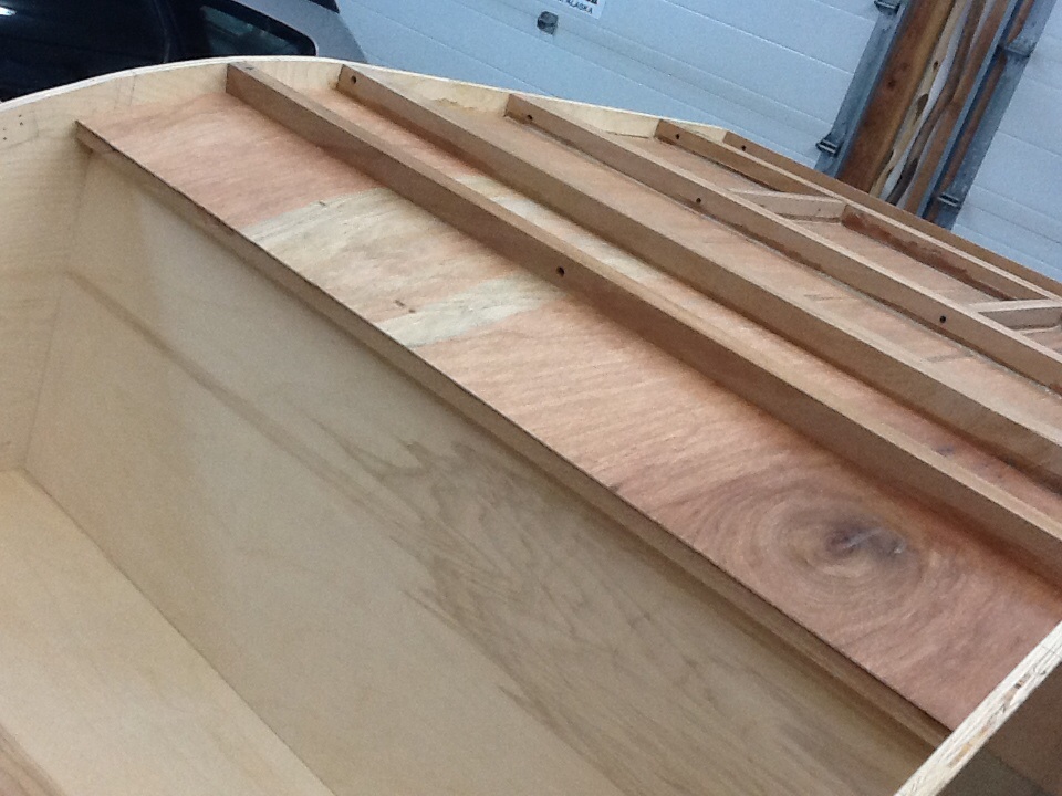

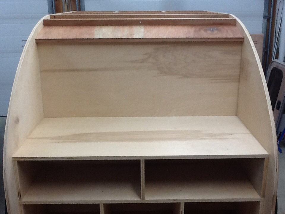

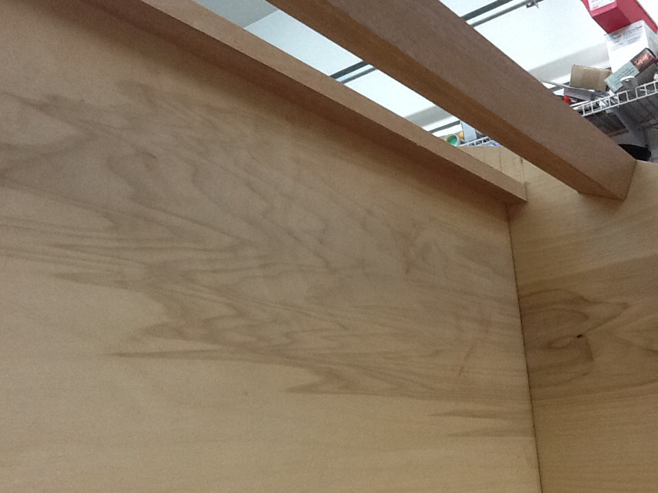

Postby ratrod71 » Sun Feb 01, 2015 5:00 pm
Here is the solution I came up with to affix the headliner to the bulkhead wall. I glued a spar onto the upper bulkhead wall on the galley side and then cut the proper angle to match the roofline. The headliner will then terminate over the bulkhead wall and be glued down.

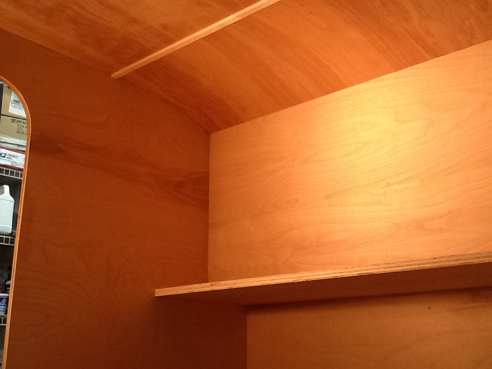

Postby ratrod71 » Thu Feb 26, 2015 11:59 pm
Pictures of the headliner installed onto the bulkhead.
