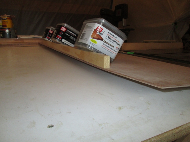

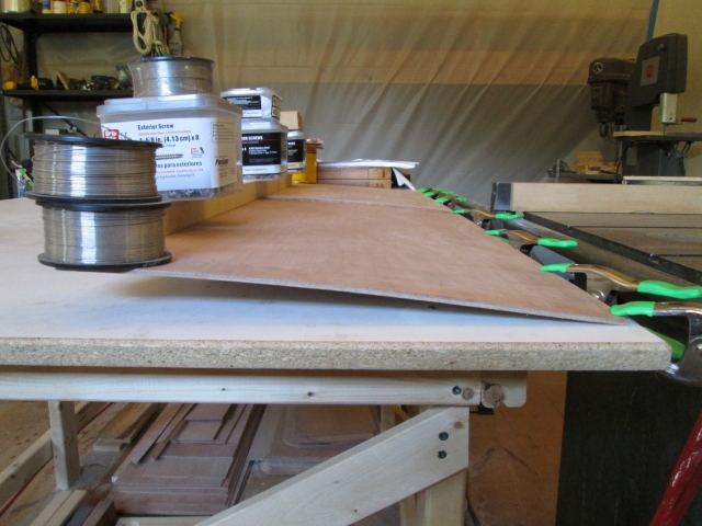

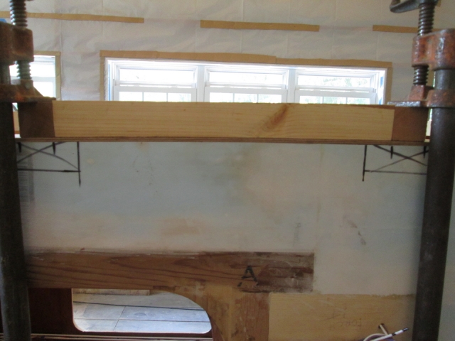

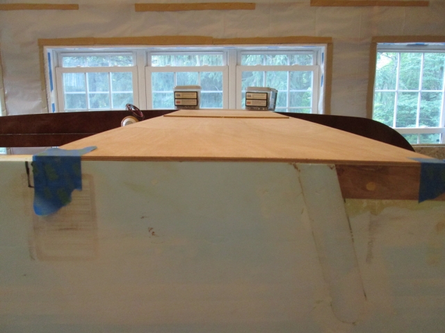

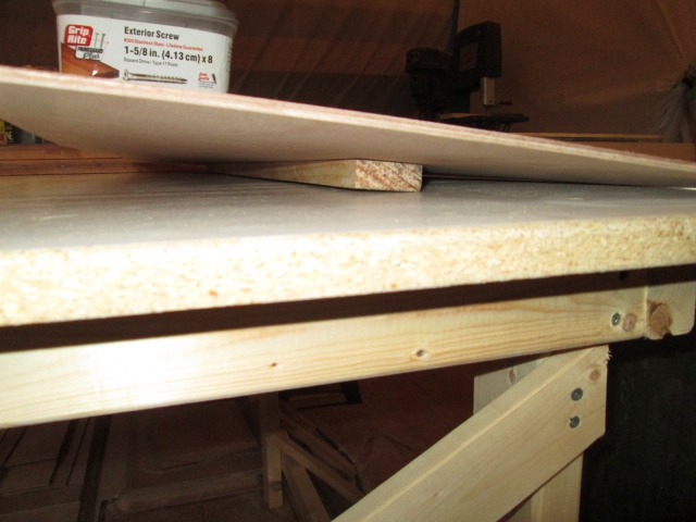

Here is the rear panel taped and weighted at the four corners. It’s difficult to see well in the pictures, but the short edges match the side profile well, while the middle remains flat.
Long discussion and numerous options were considered. At the time we narrowed it down as follows: 1) build a temporary support rib (or two) for inside the cabin to hold the panels up to the profile while completing the roof and hope that it doesn’t sag later when the supports are removed; 2) make two full length permanent ribs that run on top of the ceiling on either side of the roof vent bridging from the front cabinet face frame to the bulkhead, half lapping the spars (a flat spot, or parapet could be incorporated into the area at the vent)… 2a) option 1, above could be used and these permanent ribs could be added as a secondary step, or 2b) these ribs could be added during the ceiling bench build out and installed as a unit with the spars, skin and all; 3) add more spars spanning across the top of the ceiling.
Then I had another thought; maybe I could train the panel prior to putting it on the roof; so I am conducting a test. I clamped the rear edge of the panel to the edge of the bench, propped up on a 1x2 in the middle, and weighted with a straight edge on the sprung side.
Just 15 lbs, but I am curious to see the effect upon my return. Perhaps the humidity will help, too.

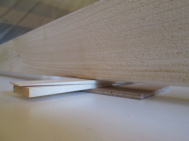

Okay, up to the loft to check on the rear ceiling panel test bend. Hmm, it looked pretty much the same. Not enough time or weight to effect much change. A test with no result is still a result. So I added a few more lbs in small MIG wire spools and a partial can of stain.
That put about the right curl in it, but I was impatient and really can’t see myself waiting an indeterminate amount of time on the chance that the technique would “set” the panel enough not to sag or spring back. So I took the weights off, and of course, it sprang back right to where it had been.
So to me this proved that side to side spars are a good idea. After all, it was the spacer under this experiment that was what allowed the ply to take the correct shape.

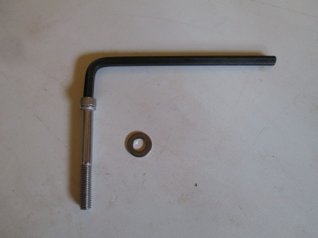

One more little thing; I snagged a 1/4 inch hex key to keep in the locker for configuring the rifle rest bolts.

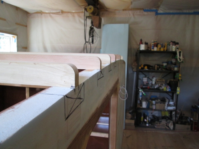

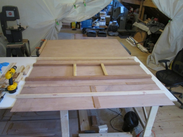

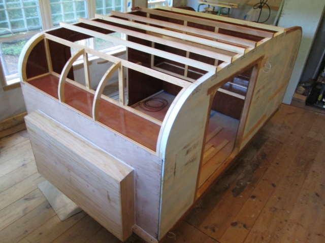

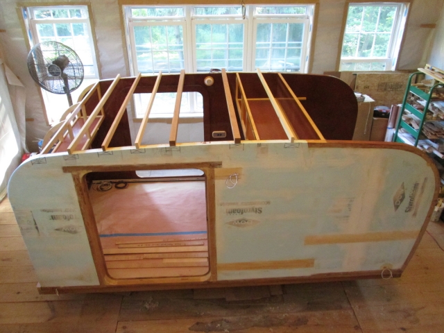

So I cut 3 spars out of the poplar, already had the 2x2 cedar spars for the vent and found that I already had a 1x2 cedar spar that would have been the front toe kick before I changed the locker configuration.
Here they are just placed into their relative positions across the walls to help visualize spacing and layout of a few more wall blocks (to be let into the tops of the walls like I did previously).
Although the spars are all cut to the full cabin width of 64 inches, some of them stick off the edge of the street side wall just a bit; two at 1/16 inch and the worst about 1/8 inch. There are a few things contributing. When the street side wall blank fell over and cracked just in front of the galley wall edging, it didn’t go back perfectly flat with the repair, and the upper rear cabinet face frame seems to have pulled the wall in just a tad on that side. I’ll probably just trim the spars flush to the wall as required and let the line of the roof follow the wall. I hope it doesn’t stand out too much when I round the edge of the roof over. I think you would have to be looking straight down the wall with a critical eye to see it.

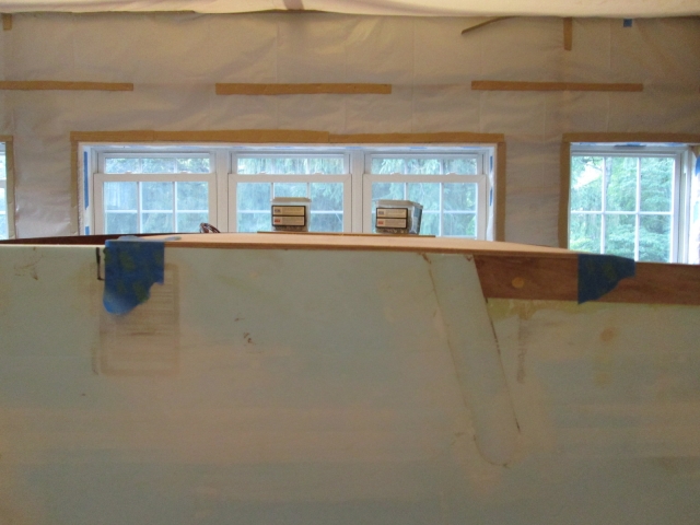

Another thing that I want to take a closer look at fixing is where the street side roof arc meets the small front radius. There is a slight depression in the profile cut there where the roof arc came in a little low resulting in a slight depression on that side. I may slap a sliver on the top of the wall and re-contour it slightly; though it may be hard to match the inner skin finish without creating a shadow line or mismatch.
Finished up the evening by cutting the new wall blocks and marking their locations out.

Today it was spar prep work.

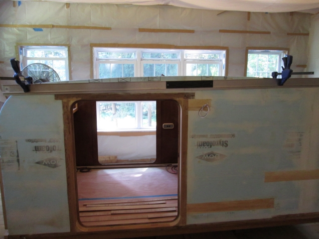

Rather than trying to force the wall/walls to conform, I started by marking and trimming the three long spars flush to the sides.
Then I shimmed the vent spars up on some 5 mm (representing the ceiling skin) and clamped them stationary using long pipe clamps hooked under the floor. That way I could trace the roof arc and radial splay of the spars onto a scrap of 1x pine to make the side pieces for the vent framework; the “vent ribs”.
From there I laid a straight line across the top of the tangent point, about 1/8 inch high at each corner, so that the vent flange will have something flat to lay on. I will build up the spars between the vent ribs using thin strips to match, then fair in the foam as required. Also note how I tried to avoid the big knot in this piece as much as possible. This meant that I had to shim one end of the board to cut the straight edge out on the table saw.

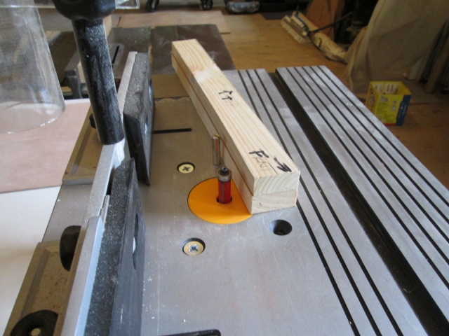

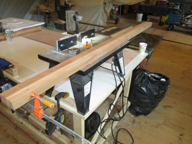

After cutting the ends out on the miter saw, matching the angles by eye, I made the curved cut on the vertical band saw, trimming to the line with the little plane and the football shaped sanding block. A little back and forth and we get this.
Here you can see the difference between the flat part and the spar. Of course the vent rib will eventually be mounted out near the middle of the roof, but it was more accurate to dry fit it here at the top of the wall.

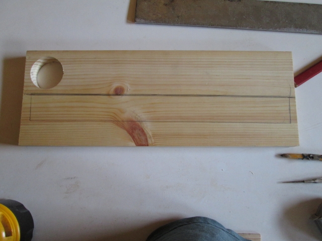

So this is basically the template. The inner and outer flanges on the vent are sized for 2x but I didn’t have any handy scraps that weren’t cupped or knotty, so I decided to sandwich some milled 1x pine. I have gotten a lot of mileage out of this piece. First it was a long sanding board (hence the tacky spray glue residue), then it was a router template for the fender and wing table blocking (hence the screw holes), and then it got ripped and used for the locker sill. Thrifty. :lol: So I traced three more ribs by lining the template up along the straight edge and running the pencil around it. The tackiness of the spray glue actually helped seat the template and made tracing easier. It’s hard to see the tracings but you can see where I marked the tops and fronts with the sharpie.
After cutting those out similarly, I stuck one to the template with double sided tape and made it match with the flush cutting bearing bit on the router table. By using the post to start and the far end of the retracted fence to end, I was able to run the narrow piece thru without getting my hands too close to the cutter. (Thank you to whoever it was that pointed out the proper use of the starter post to me!)
Here are the first two fit between the spars as a look see check.

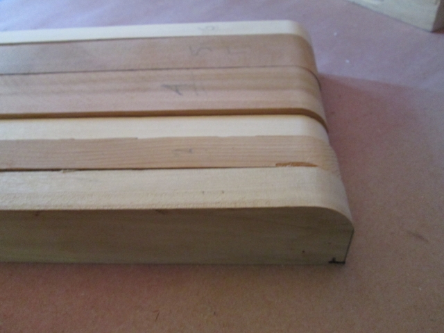

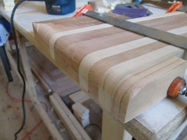

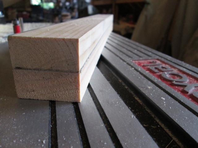

Rather than trimming the other two rib blanks now, I glued one of the blanks to each of the trimmed parts, aligning the ends and straight edges and pinning the pairs with a few pin nails so they wouldn’t slide out of alignment under the clamp pressure. Note how I stacked the pairs under the same set of clamps. Later, after these had a chance to set up, I ran them around on the router table again to get two identical 1-1/2 inch wide ribs.
Next I ganged the vent spars together, found the center, and laid out the locations where the ribs will get glued and screwed between. The fan is a hair over 14 inches square, but the flange is about 2 inches wide with the screw locations about centered on the width of the flange. That and leaving some room for the wiring meant that the rough opening was comfortable at 14-1/2 inches.
Side note: Since these two spars were no longer exactly the same length, I had to decide where the center was, or in other words, where the offset needed to be. So I laid the big aluminum straight edge along the top of each wall and found that it is actually the curb side wall that has the slight bow in at the top. The street side wall is actually very straight on the outside. Anyway, knowing that allowed me to know which ends of the spars to match, and which to let run.

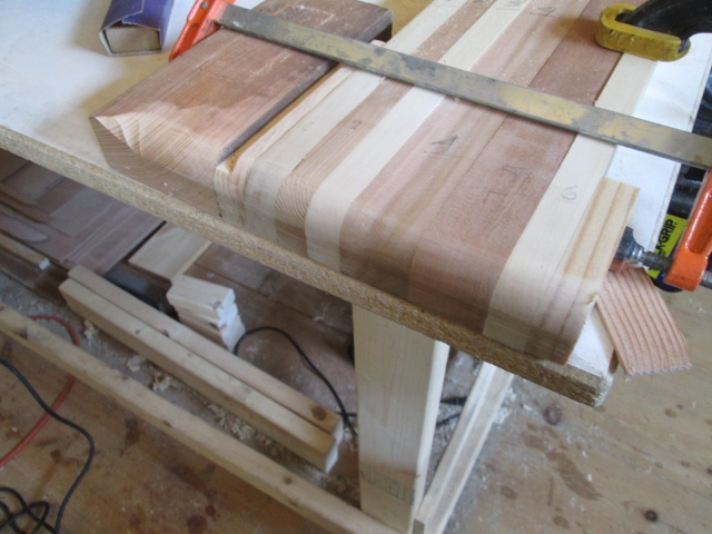

Next I ganged up all of the spars, squared and evened them up, planed the ends of the tops flush (the cedar was a tad shorter than the pine), and clamped some waster blocks on each end to prevent breakout. Then hit them with the 3/4 inch round over bit in the 1/2 inch collet router, making progressive passes.
Just a few hits with the small sanding block.
And the other end.

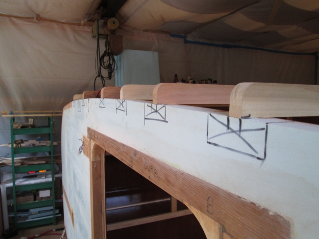

And a little look see with the spars resting on top of the cabin. Street side looking back.
Curb side looking back.
And a couple looking up from the curb side.

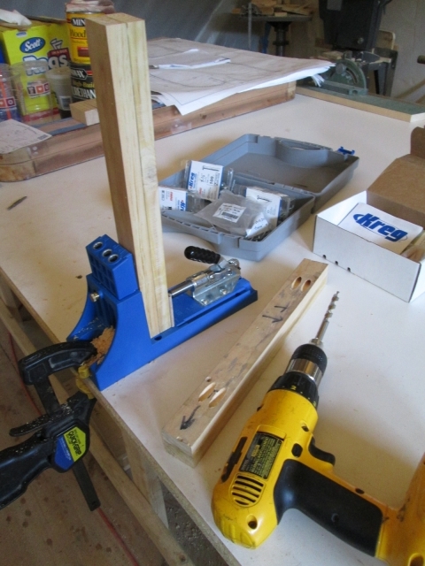

I finished up (about 4 hrs work) by drilling the pocket holes for the screws in the vent ribs.

Let’s get caught up. On Monday I futzed around measuring and test fitting ceiling related stuff. The third spar will sit on top of the butt splice backer for the front and middle panels so it needed to be ripped down by 5mm (3/16 inch). Here it is in order with the others after being ripped. You can see that it is no longer as tall.
The 6th spar goes over the rear cabinet, so I had to remove a portion of the butt splice backer on the pieced together rear ceiling section. Here it is dry fit.

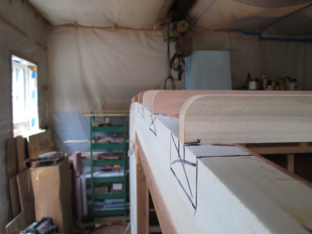

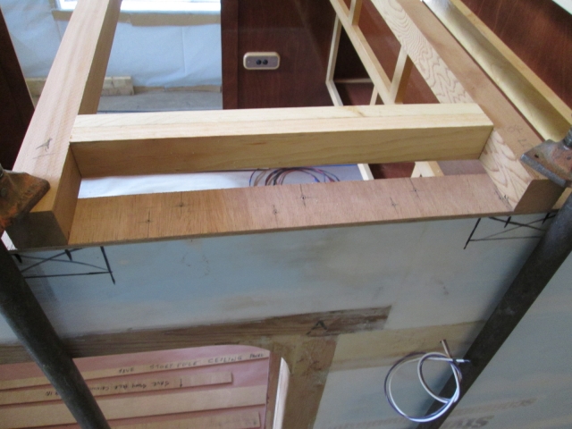

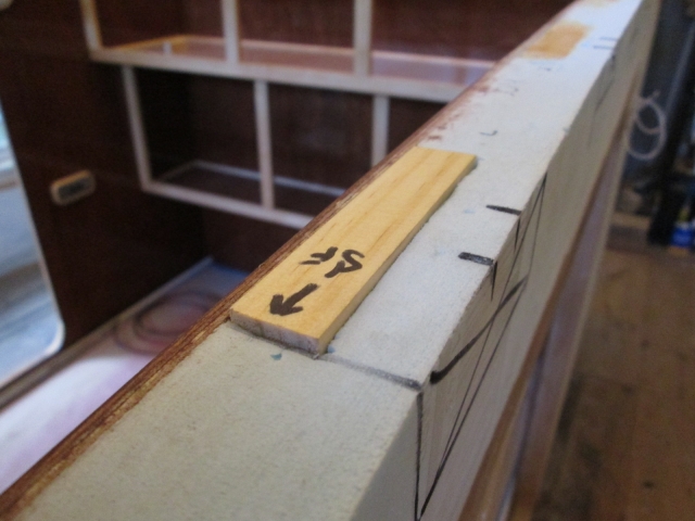

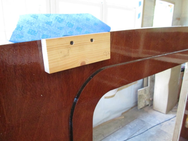

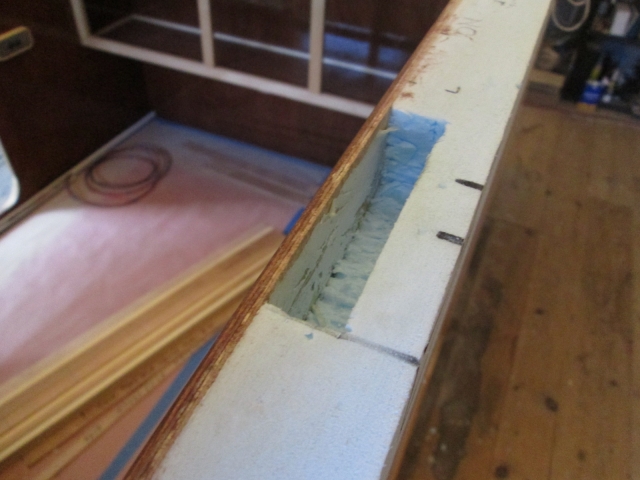

On Wednesday I started cutting/chiseling out the pockets for the extra blocking in the tops of the walls where the extra spars will be screwed down into.
These were purposely fit a tad shallow; I would rather shave the blocks down to the profile after gluing than have them be low.

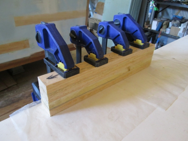

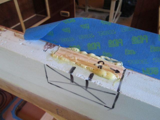

I took the 4th off. Today I finished up fitting the four new blocks and glued them in using the same technique as the others done previously. I masked across the top edge of the inner wall skin to keep GG ooze from dripping down the nice finish, and glued them in. Here the glue is just starting to kick.

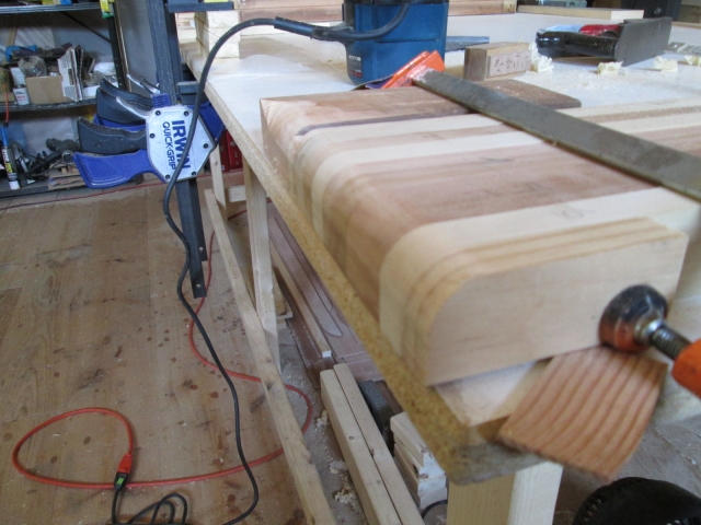

On the inside of each location I screwed a good size temporary block. This pinned the glued blocks into location, helped spread the load so as not to damage the finished wall, and kept the screw heads from digging in. When these are removed there will only be small screw holes that will be filled with the colored putty, and will hopefully virtually disappear.

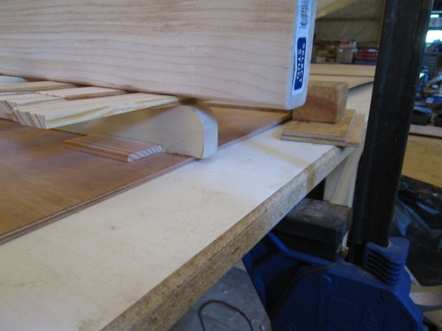

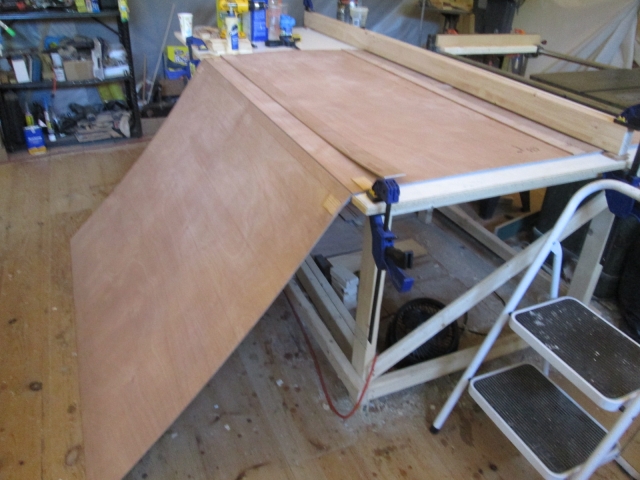

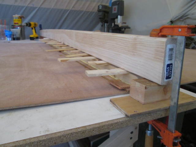

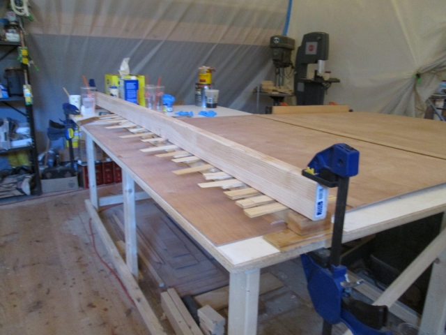

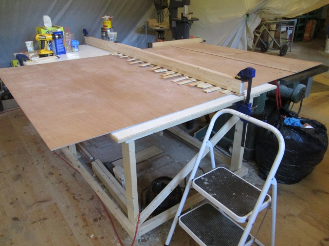

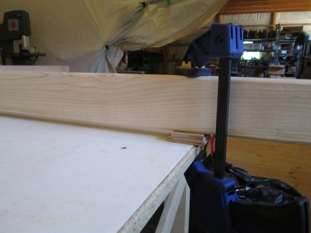

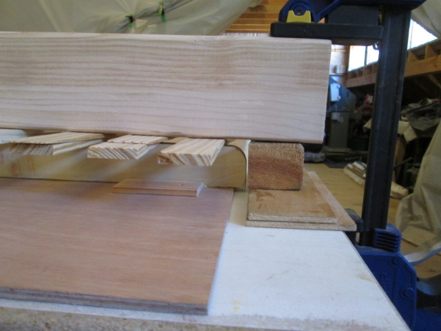

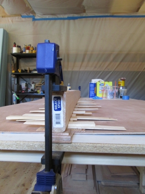

While that was curing I set up this clamp bar bridge. It’s a 2x4 x 8ft clamped to the edges of the work bench on top of 3 scraps of 5mm at each end.
This left a gap between the 2x and table where I could slide the ceiling panel under and use wedge shims to clamp all along the field of the seams.

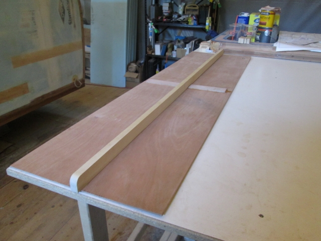

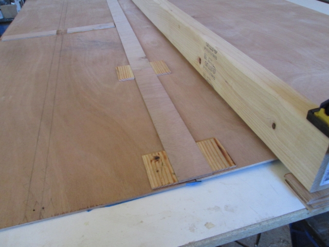

This is the rear ceiling panel on the left, the two piece butt splice backer strip, and the middle ceiling panel under the clamp bar on the right, all ready to be slid under the bar after applying the glue. The small shims of fir on either side of the backer are temporarily double sided taped on to help position the backer and keep it from sliding around in the glue.
Since this seam will be glued onto the top of the rear cabinet face frame, I hadn’t bothered to make the butt fit perfect, and with the slight gaps here and there it seemed like more glue would ooze thru it than would fasten it, so I let the backer do the work and didn’t bother to try to glue the edges of the panels. Here it is under the “clamp”.
Even with the 2x4 on edge, the wedges are a powerful tool and put a goodly arch in it; and then it would relax and the shims would loosen up. So the process was put the wedges in, go back and re-shim all of the loose wedges until they were all about the same snugness, wait a little bit, then go back and snug all of the wedges back up again.

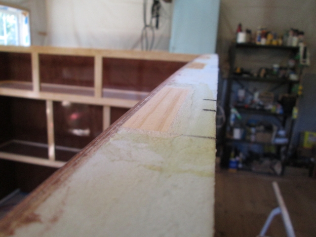

As the GG was oozing out of the wall blocking, I went around and scooped some of the excess off to keep it from dripping down the outside of the walls. Apparently I had used plenty to make up for the slight roughness of having gouged out the pockets.
Here is an example after removing the masking, cutting the excess glue, shaving the blocks down close with the block plane, and finally sanding flush with the little hard block.

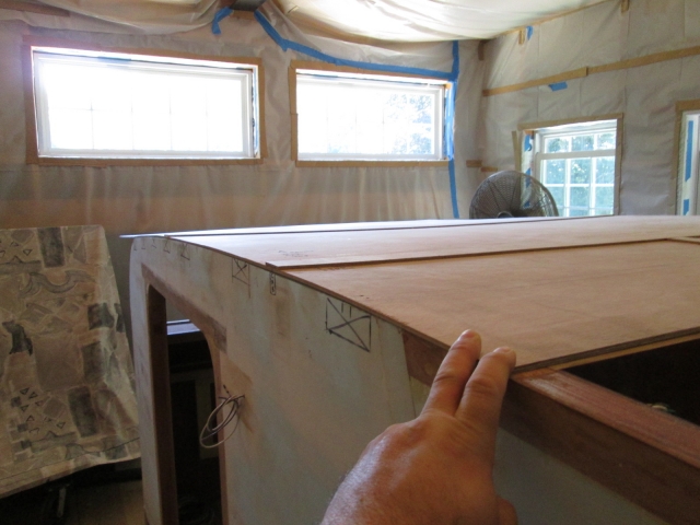

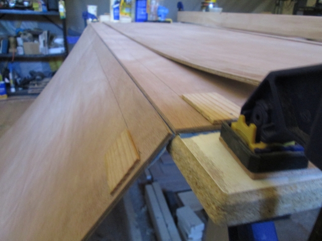

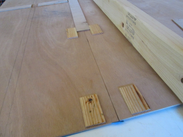

Next, I took care to match the two edges of the rear ceiling panel assembly and the front panel. For this seam, the main ceiling seam in the cabin that will be visible, I improved on the technique that I used to join the two halves of the rear ceiling panel together. Before taping along the seam on the good/bottom side, I taped along both sides of the seam first. That way if the tape holding the seam together should happen to separate when I folded the joint open to apply the glue, at least the wood would still be protected and hopefully not get glue on the face. It actually worked out better with the longer sheet because when I dragged it off the front of the bench it touched the floor without opening fully to 90 deg’s. The angle tended to match the chamfer on the edge of the bench, backing up the tape and keeping it from pealing open further than intended.
So with it in this position, with the backer piece traced out and near at hand (the curled up piece), I applied glue to all surfaces; inside the butt joint, adjacent to the seam, and on the underside of the backer.
Then I slid it back up on the table, flipped the backer into position, slid it under the 2x4 bar, and wedged it up.
Since I couldn’t really reach the middle of the table, the step stool was handy by so I could climb up and sit or kneel on top to work.

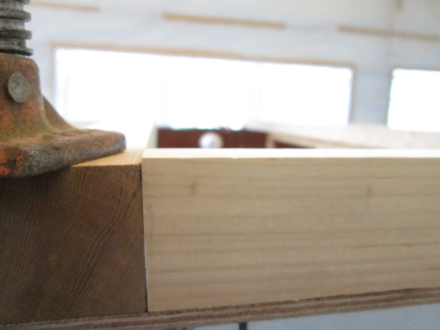

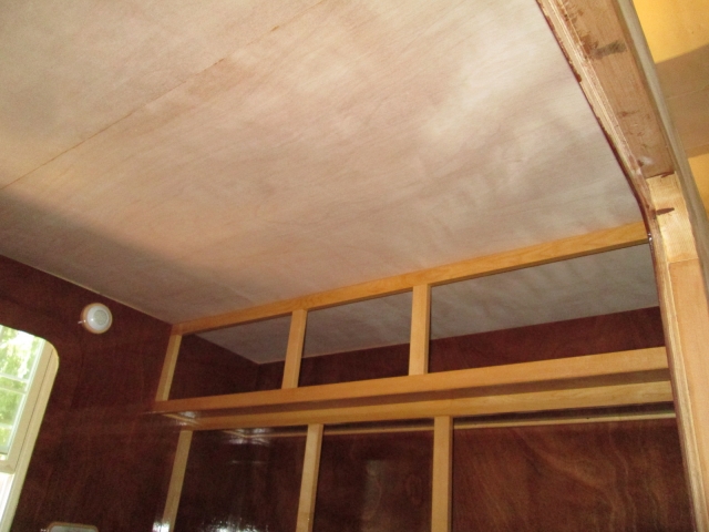

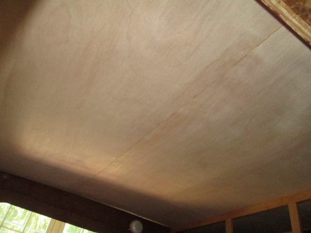

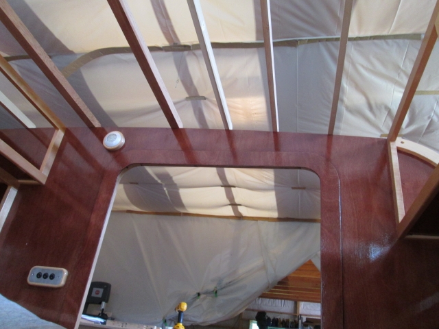

The visible skin joint came out really nicely; I’m very happy with it. Here Karl and I set the skin up on top. It’s flush to the street side in the pic because I haven’t notched out for where the vent fan wires come up thru the curb side wall.
Still sags in the middle without the spars.

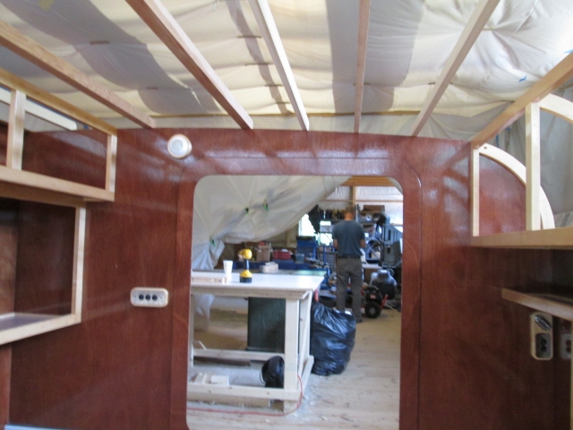

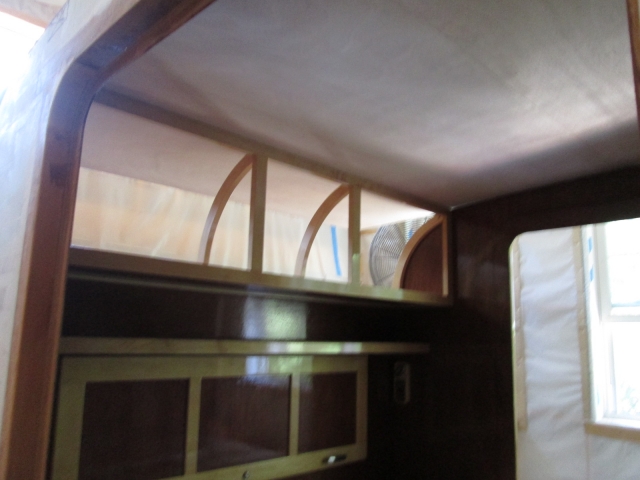

Gave a real sense for how the inside will be; seemed a lot smaller all of a sudden, but not in a bad way. You can see the panel butt seam here.
With the front still sprung out over the riblets it gave a nice transit lighting effect.

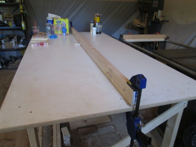

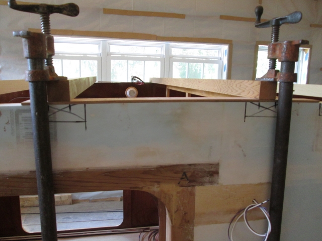

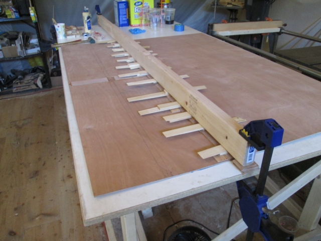

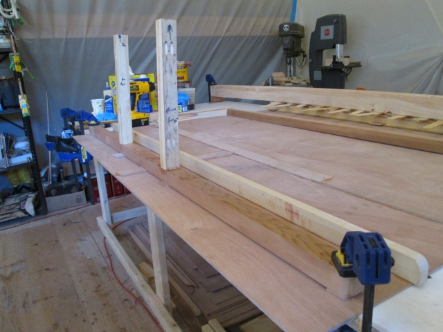

Moved the clamp bar location on the bench and added appropriate spacers to glue the 6th, rearmost spar.
The wedges were powerful enough to compress the pads on the nearside quick clamp enough to lift the bar off the spacers.
I forgot to show this on the 6th spar, so I will show it here on the 3rd spar. The temporary locating pucks with double sided tape did a great job locating the spar from front to rear, but I used a single screw up thru the good face (where the hole will later be hidden on top of the street side wall) to pin the spar and keep it from moving across the panel. Also note the pencil line to help me align the spar overhanging the skin by 1/2 inch (shown here upside down just before applying glue).
Here it is all glued up and under the clamp. Note that I switched to a steel threaded clamp at this end of the bar.
While that was curing I clamped the rear vent spar, the 5th, on its back face (working on spacers right on top of the ceiling skin), and glued and screwed the vent riblets into place.
After that all had some time to set up I broke down the clamp set up, cleaned up the glue joints and set the vent framework in place (just dry for now) to layout some square reference lines and take a pic of progress so far.
