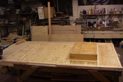

my floor is 1/2"plywood. I glued the edges and covered the seams with 3/4x2 strips. I used thickened epoxy for the glue and the seans match up with supports on the frame. The tear i'm building is a 5x10 so the ply runs across the floor. (the floor is upside down in the photo) There is no advanage to "squeezing" the joint . with epoxy you will have a "starved " joint and it will be weak. I just line everything up, epoxy it then hold it with nails while to drys
