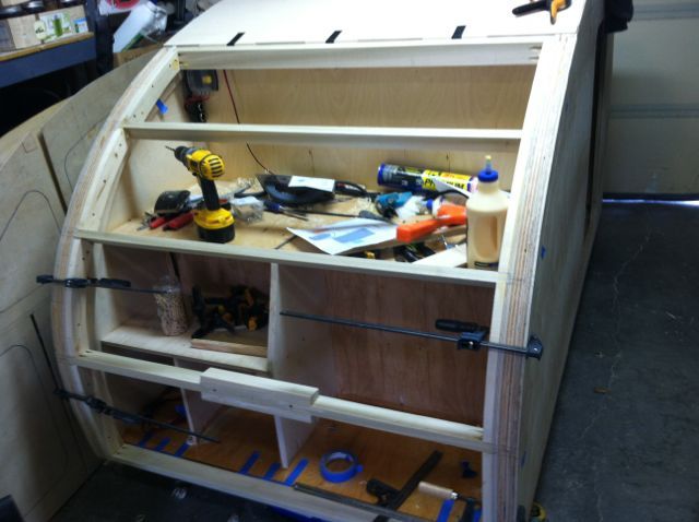

Here's a 4x8' I built for my sis. I tried to talk her out of the fore and aft bottom curves since she lost 8" with those. But she loves it this way it is, so what the heck?
I placed the hatch spar just behind the upper bulkhead and attached both the spar and the bulkhead to each other. They'll be no flexing of the hatch spar.
In the real deal, the rear bulkhead went all the way to the roof. I vetoed the 8" rear shelf she added, BTW.
The fact that Benroys don't have a rear profile that curves back in will help your headspace when your hatch is open.

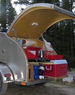

I think the galley hatches that stop at counter level are because they are 8' long drops and there's limited storage between your toes and the rear of the 'drop. Here's my 5x10' galley. I think you're making a mistake if you stop your hatch at the counter.
