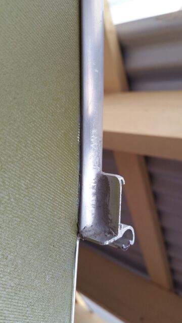

Postby dales133 » Sat Jan 02, 2016 2:33 pm
Mines not complete yet but ive followed the general consensus of how its done and will post some pics for you shortly
dales133
Posts: 4605
Re: Hurricane hinge photo request

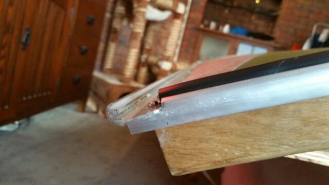

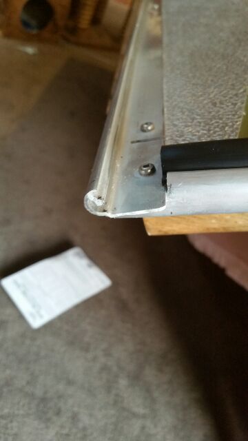

Postby dales133 » Sat Jan 02, 2016 2:48 pm
This is the hatch side of the hinge detail.
Ill go get some of the body detail.
My hatch isnt currently fitted
dales133
Posts: 4605

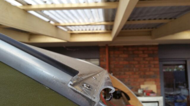

Postby dales133 » Sat Jan 02, 2016 2:58 pm
This is the body side of the hinge.
Hope this is of sme help.
