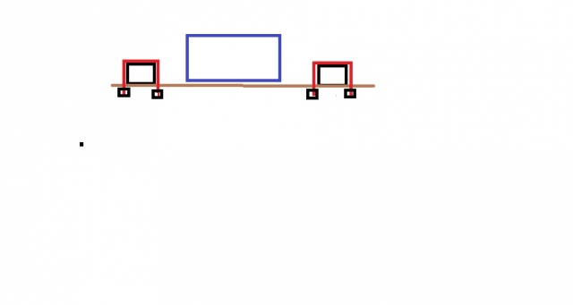

Square shouldered "u" bolts maybe ????
BLACK..FRAME RED U BOLTS BLUE BATTERY BOX
Here it is nestled between the frame setting on a light gage steel plate. When you bolt the box to the plate use large fender washers to disperse the load and I put in a small piece of 3/4 blue foam to protect the battery case (not the battery box ) the battery bottom from the bolt heads.

Postby Dalorin » Thu Apr 16, 2015 2:18 pm
All,
Thanks for all the good information.
@bonhenrey I'm going with your solution because it's impermanent. Someday I may want to reconfigure the things on my tongue. Thanks for the help!
