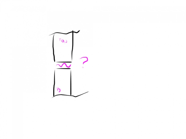

Re: Weather stripping
Postby OP827 » Mon Apr 20, 2015 10:42 pm
Very very roughly, this is the kind of arrangement I am looking to seal. Interested whether there some standard detail sketch being discussed before...

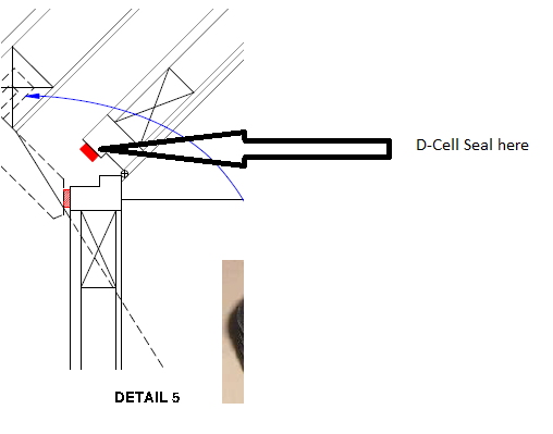

Postby KCStudly » Tue Apr 21, 2015 1:58 pm
My assumption, and from looking back at your initial sketches on your build thread, was that your lifting roof sides would be outside of your lower fixed walls, and that you are asking for a way to seal between the two, side by side (like in Sect A of the Winter Warrior plans, pg 7).
In your sketch above, I'm assuming that this is for the folding hard wall filler sections. I would think that the 'D' shaped hatch seal would work well there; just dado a groove wide enough for the seal to compress and to prevent the seal from over compressing.
For the sweeping side seal, such as for a Winter Warrior, upon review it looks like the plans just call for a brush style sweeper. This is where I was thinking that people have used the garage door style seals (IIRC). My thought was to position the seal so that it does not contact the sides, and to have raised areas, or beveled ramp strips, where the seal comes to rest at the ends of the hatch travel. These ramps would take up the extra clearance and give the seal a spot to land. With only 6 mm (or 1/4 inch) clearance between the inner and outer that might not be very practical and still have room for both clearance and seal compression.
Postby OP827 » Tue Apr 21, 2015 4:29 pm
KCStudly wrote:My assumption, and from looking back at your initial sketches on your build thread, was that your lifting roof sides would be outside of your lower fixed walls, and that you are asking for a way to seal between the two, side by side (like in Sect A of the Winter Warrior plans, pg 7).
Thanks KC, I did not know about those WW plans. My design has evolved from original boxy trailer with top over the walls to a streamlined clam shell resting ON the walls to save on the trailer width and streamline the shape. I will have mainly three types of seals:
1. As shown above on rough sketch. If I understand your above information correctly, I can use a D-cell glued to an upper wall with a rabbet on the lower wall to match it as you have advised. Pretty much the same as shown on Winter Warrior plan page 6:
This is very important seal between the roof shell and lower wall (when folded) and hard wall filler sections (when unfolded). It will be 10 ft long. Do you know where I can find design compression forcec for each d-cell seal in catalog so I can select the proper one based on the roof weight? .
2. Brush type and blade type for vertical sliding detail, WW Plans Page 7. I think I can figure out how to select those.
3. Blade compression on vertical seals of filling hard walls. I will size them based on expected tolerances and movements.
Cheers :) :thumbsup:
Postby KCStudly » Tue Apr 21, 2015 5:43 pm
I don't think you need to be all that specific.
The big thing is you don't want to fully crush the seal like a gasket. So for example, using Grant's hatch seal at .400 tall x .625 wide free height, you only want to compress it to about 2/3 it's original height, or to about 1/4 inch high. The sides of the seal will bulge out, so you need to leave some width in the rabbet for that. IIRC, when I checked mine that seal went to about 7/8 inch wide when fully compressed. I'd have to double check that to be sure.
So, IMO, you want the hinge side of the joint to come together face to face hard (to take the wall load) but you want to leave a space about 1x 1/4 inch for the seal. That space could be divided top and bottom, or could be just on the bottom with the seal adhered to the flat underside of the upper piece. I suspect that the zig-zag joint in the WW design is there to both key the walls together for strength, and to add a labyrinth or cofferdam effect to help keep water out.
Grant's seal does come with a self-adhesive backing, and when I spoke with him he said he doesn't see any problem with squeezing it down a lot further (it will go to about 1/16 inch), but the seal manufacturer's tech info that I have found say that 1/3 to 1/2 free height is the rule of thumb for long seal life.
