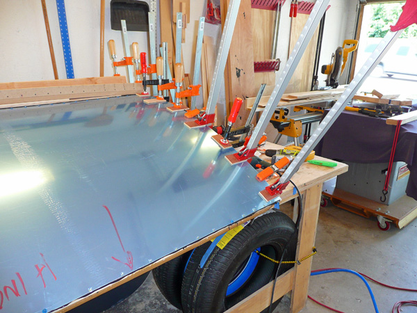

I put the top piece on first. I attached it to the front bottom with about four flathead stainless steel screws that are countersunk. Then I tighten the straps and monkey around until it's as square as it's going to get. Then I attached it to the hatch spar with three or four screws that are also countersunk. These will be under the hinge (make sure you don't put them where the hinge screws will be). The front ones will be covered with trim. (I'll route the fan hole in later....)

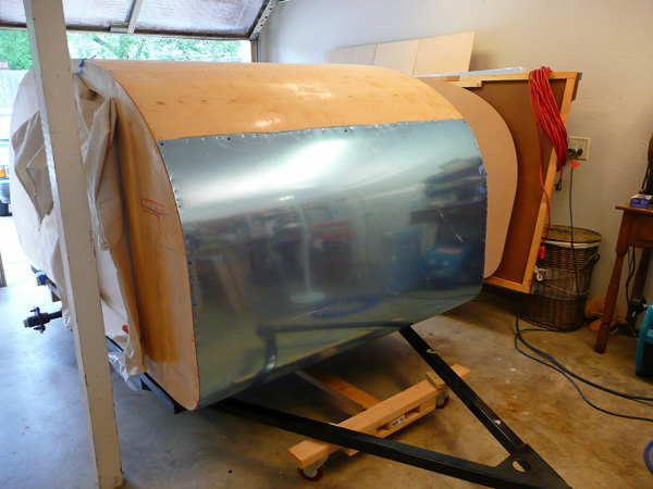

If you look in this photo, I've got 1 x 2's between the cabin and the dollie. I'll set the side piece on those. (I cut the side aluminum about a 1/4" proud). Once it's set on the boards, I can clamp it onto the door opeing and galley edge using spring clamps. I'll then place four countersunk FH screws around the door. (Take a look at your doors to see how close these need to be. Perhaps as close as 3/8".) Then I'll trim with a flush bit router. (Put some blue tape on your roof piece to protect it from the bearing. And some blue tape on the sides so your router base doesn't drag a piece of aluminum across it.)
Now you can start putting on your trim. I dry fit the it, remove it, and then add sealant and screw it back in place.
This next pic is of sheathng on my first drop. Of course I built on the chassis like most do... (I don't do it like that anymore). I put a couple of 6 penny finish nails about a half inch between the chassis and the cabin. One up front and one back by the hatch. After the aluminum is on, I pull the nails and stick a daub of sealant where they were. It works well.

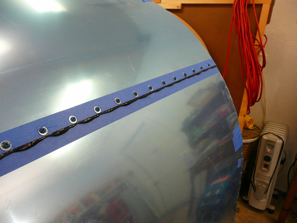

I did front and roof first, then the sides, and finally the hatch. I "floated" the aluminum. There is sealant along the edges and around openings only. I stapled the aluminum to hold it in place. (Staples were located only where trim or laps in the aluminum would cover the staples.)
